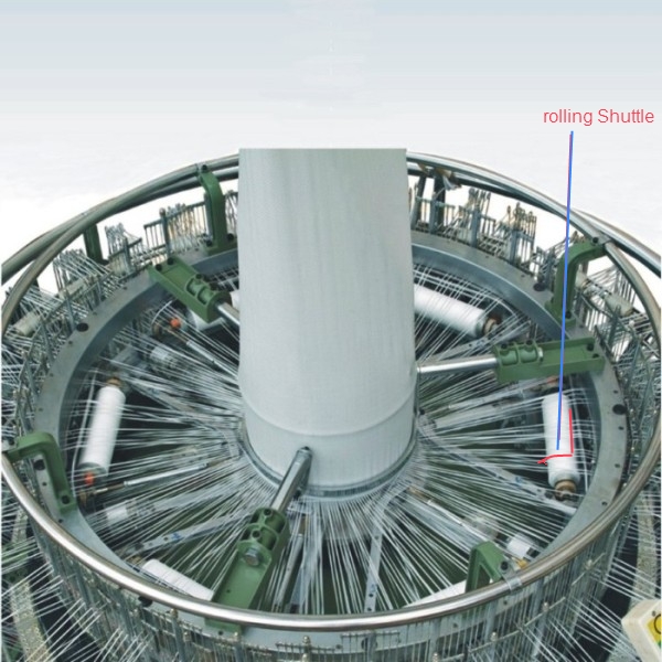

Hi guys,
Today I were at a sack producing factory.
At the woven line there was a circular loom (like the typical below picture but it had 4 shuttles).
I am not sure how many of you have seen a such device, but it mixes
the warp and ther woof and produces an integrated sack.
The device stops working automatically when a woof (those innumerable strings which seem to be the radius of the circle in the picture!) is broken or
cut off. But unfortunately there is not a such option for warps which come out of the 4 SHUTTLES (I have shown a shuttle by a blue line), when the shuttle's string cuts off the device keeps working and produces an odd sack.
Unluckily the shuttle rotates both along its axis and along the circle (the raising sack) (I have shown it by those 2 read lines).
The electric technician of the factory asked me if I am able to solve the problem?
I used a mirror and an INFRA RED system to solve the problem. The mirror were mounted on the shuttle's string so that it were hidden till the string were cut off, after that the mirror came out and reflect the infra red light which were emitted of the infrared system and by this trick the loom were stoped.
Now they want me to think of another way to do a similar task but does not CONTACT to the shuttle's string.
As I mentioned before the shuttle has 2 kinds of rotation so I am not able to handle it by any external power. When shuttle's string is broken the shuttle stops rotating along its axis (not along the circle, as you know).
Does every body know any solution please?
Thanks a bunch

got a video of it? preferable slow motion. I have a few ideas but can not tell from your description if they will work.
The most difficult would be if all six motion in a continuous 360 around the bag.
Dan
They are 4 really.
Yea I have gotten a small video, but not sure if it is helpful or scarer;)
Yes those shuttles rotate around the sack by 360 degree continuously.
I thought of induction sensors but unfortunately it seems they do not work too.
The technician wants a strong trick for the shuttle.

Another suggestion is to drill a hole in the shuttle and fix a tiny tiny Neodymium cylindrical magnet. Make sure the magnetic pole is pointing in a radial direction to the axis of the shuttle.
The small physical size of the magnet would not unbalance the shuttle in operation.
A biggish coil is placed over, under or near the shuttle traveling plain. Because of the strong magnetic field of these small devil magnets, the positioning of the coil can actually be quite far away.
If the shuttle is rotating while traveling in a circle, then the coil will pick up several magnetic pulses by the passage of each shuttle. If the shuttle is not rotating, only a single pulse will result.
With some clever IC logic or via a microcontroller, such condition can be detected and acted upon.

mm, Ive had a bit to do with shuttle controls on looms. They have extremely fast and sophisticated control systems. Are you sure the manufacturer hasnt got a solution?.
his does not, did you see the video clip? It is a purely mechanical tube loom.
I believe you are remembering fancy automated pattern looms, all he has is a tube weaver. While mechanically intricate, electronically minimalistic.
Dan
Dan,
You should reread eblc's post. He posted what I consider a valid solution to the problem but you appear to have misinterpreted it. To reiterate his post, if the shuttle is rotating then multiple pulses will be observed, if stationary then only a single pulse.

Do you want me to use a microcontroller and configure it to WAIT for a period of time for numbers of pulses it detects? I am thinking of the possibility of your trick yet. But do you know we have MULTIPLE pulses without regarding to the broken shuttle? There are 4 magnets on 4 shuttles which rotate around the sack too, and would be detected by the sensor (i.e. coil) as multiple pulses.
Thanks for all responses,
eblc,
A microcontroller would be required as this is a complex problem. The timing of the pulses will define if it is a stopped shuttle going past the detector.
What mechanism stops the machine? A PC? If so then the PC can count pulses and no uC is required.

If the shuttle is spinning then you will get multiple pulses per quarter rev. If stationary then you will get one.
Look at the video... string is coming off the shuttle causing the spinning that he wants to sense. in addition the shuttles are all spinning around the unit being manufactured, so even if ALL the shuttles stop spinning you will continue to get pulses from the motion of the structure.
You can not rely on multiple pulses as the shuttles pass the sensor with out more information, namely the ratio of the weave radius to the shuttle radius.
Dan
The (my) assumption is that the shuttles spin multiple times per revolution of the main unit. If per revolution you normally get 50 pulses then all is well. If you get 40 then one of the bobbins has stopped. If you get a little more clever then you may see 12 pulses per quarter and when a bobbin stops you will see no pulses per quarter.
We have the ability to count pulses at megahertz, counting pulses in a quarter of a revolution of any mechanical device is trivial.
