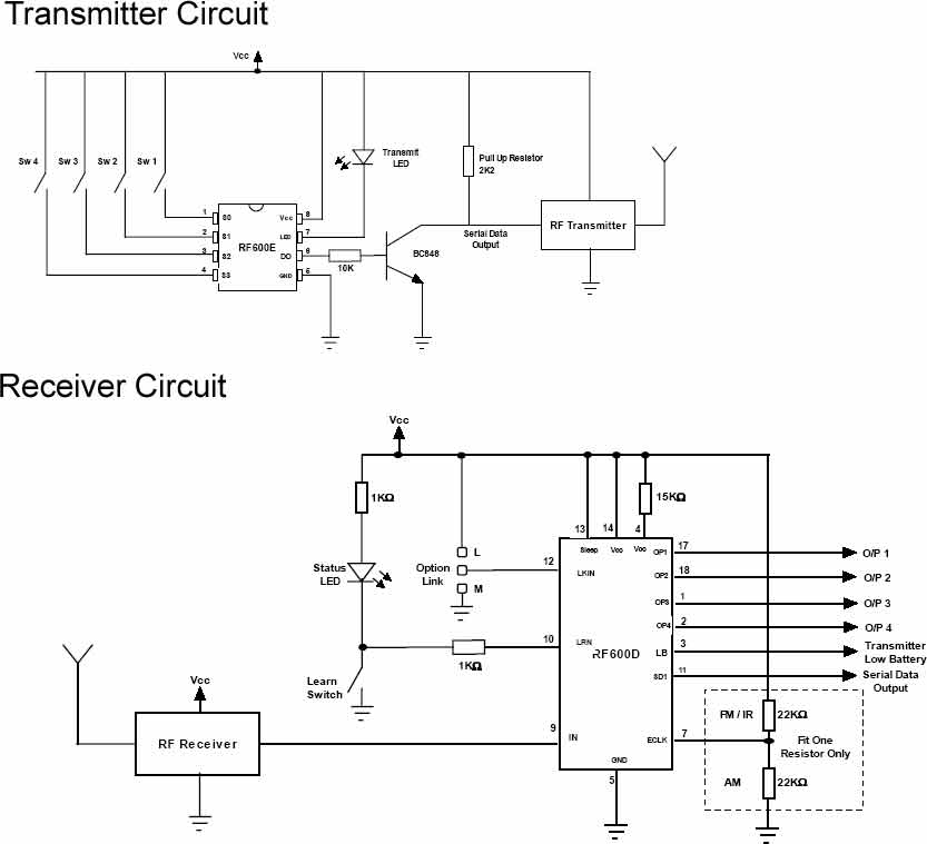

I'm trying to construct a simple transmitter and receiver, where the receiver can recognise numerous transmitters. I've made the circuits using the RF600 encoder and decoders but can't get them to work. I've tried both AM and FM transmitters.
I'm certain the circuits are working, for some reason the transmitter won't transmit. I've made the circuits on copper strip board and have been told this may be the problem and should try cutting the strips so they don't travel the full length of the board. I have tried this but they still don't work. I'm using 3 AA batteries which gives 4.5 volts power, they are low power radio circuits and im wondering if the power source may be a problem (too much/little current?).

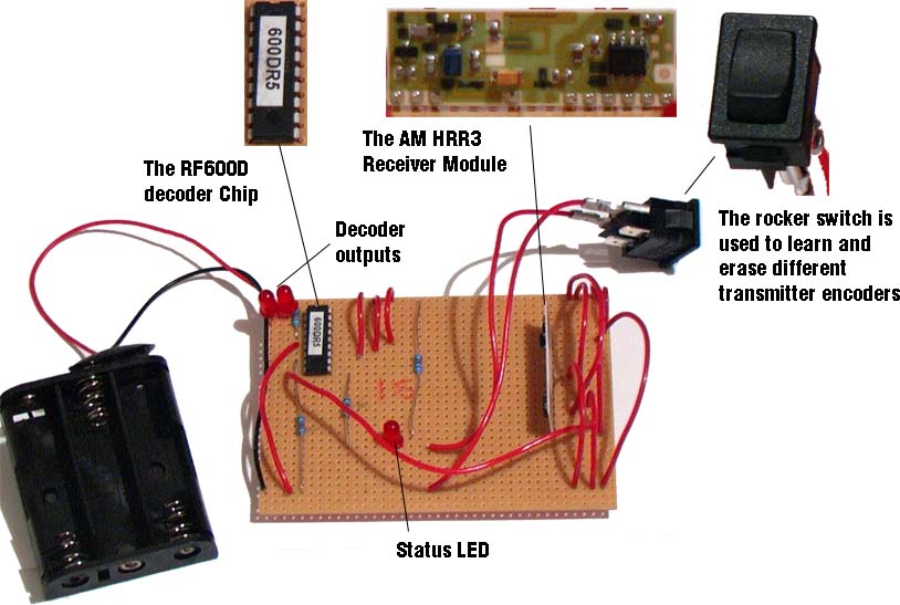

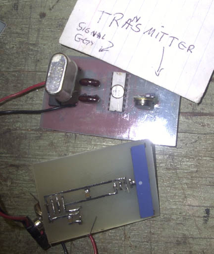

A schematic or picture would help. Look at the transmitter and receiver that I use, I bought them from Q Kits. The antenna is by Yageo, available from www.mouser.com. The upper board is the transmitter and signal generator, the lower board is the receiver, shown upside down to show the antenna. The range is in excess of 300 feet.

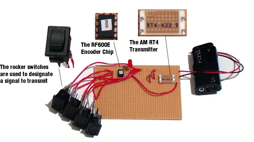

i think i've worked out how to add the images now, the only difference with the transmitter circuit now is that i have added the BC848 transistor since these photos were taken, i'm almost 100% certain the circuits are connected correctly as the chip flashes the led to say its transmitting and at the receiver end the LED lights to indicate it is waiting for a transmission. But no signal is received.

Is it possible to test whether the receiver circuit is working? I think the transmitter's working as the antennae pin voltage rises when a transmission is attempted
There is not enuf info at the RF solutions website, but I think there should be a DC level at the data output when an unmodulated RF signal is received. What are you using for an antenna? There is none shown in the photo.
I've tried using a piece of straight wire on each circuit at a length of 17.5 cm, this is what is recommended for testing purposes in the data sheets.
I am unable to test the data output level at the moment as i'm not with the circuits but i'm sure last time i tried there was zero voltage on all outputs
