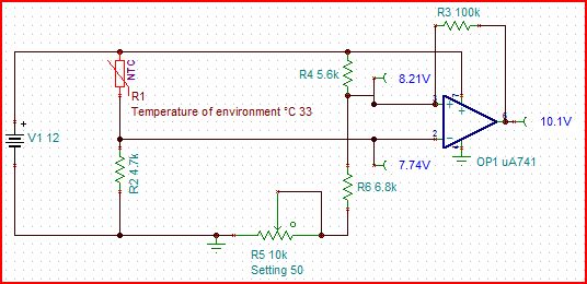

I'm trying to do simple incubator using thermostat found Here , but faild to find the correct values of Rs that make the window of ( 35C to 39C ) required for good hatching chance.
my NTC (R1) is about 9k in room temp and around 7k under the body temp ( around 37 C), R2,3,4,6,7=10k and R5 is a pot 10k. I've added a capacitor of 220uF parallel to the relay k1.
With the above values, I've turned R5 both sides fully, yet no response to the temperature change.
What do you think that I need to correct ?

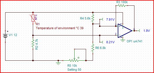

Not sure why you changed the resistor values from the original schematic. But with your component values the circuit will never operate correctly. Comparators are all about proper biasing.
Anyway, try this: (note OpAmp comparator +input voltage level [Reference] and -input voltage level [variable set by R1 temp] and corresponding output levels)
Circuit with Temp at 33C:
Circuit with Temp at 39C:
The output levels are completely adequate for operating an on/off circuit (transistor driver/switch, relay, etc.) for your heater.
You may have to adjust some values but I think the 10K pot should be able to compensate for any oddities of the thermistor.
Note also the hyterisis (6 degrees C) is a little greater than your stated desire swing. Just try it and see.
<EDIT> The SIM thermistor I used is a 10K NTC type with a B25/85 thermal constant of 3.522K. Your's may be different. If so, let me know and I can adjust component values to compensate. Or you could play with circuit values.
Wrong resistor values in post #1. Cowboybob beat me to it :)
Increase R3 in his circuit if you want less hysteresis.

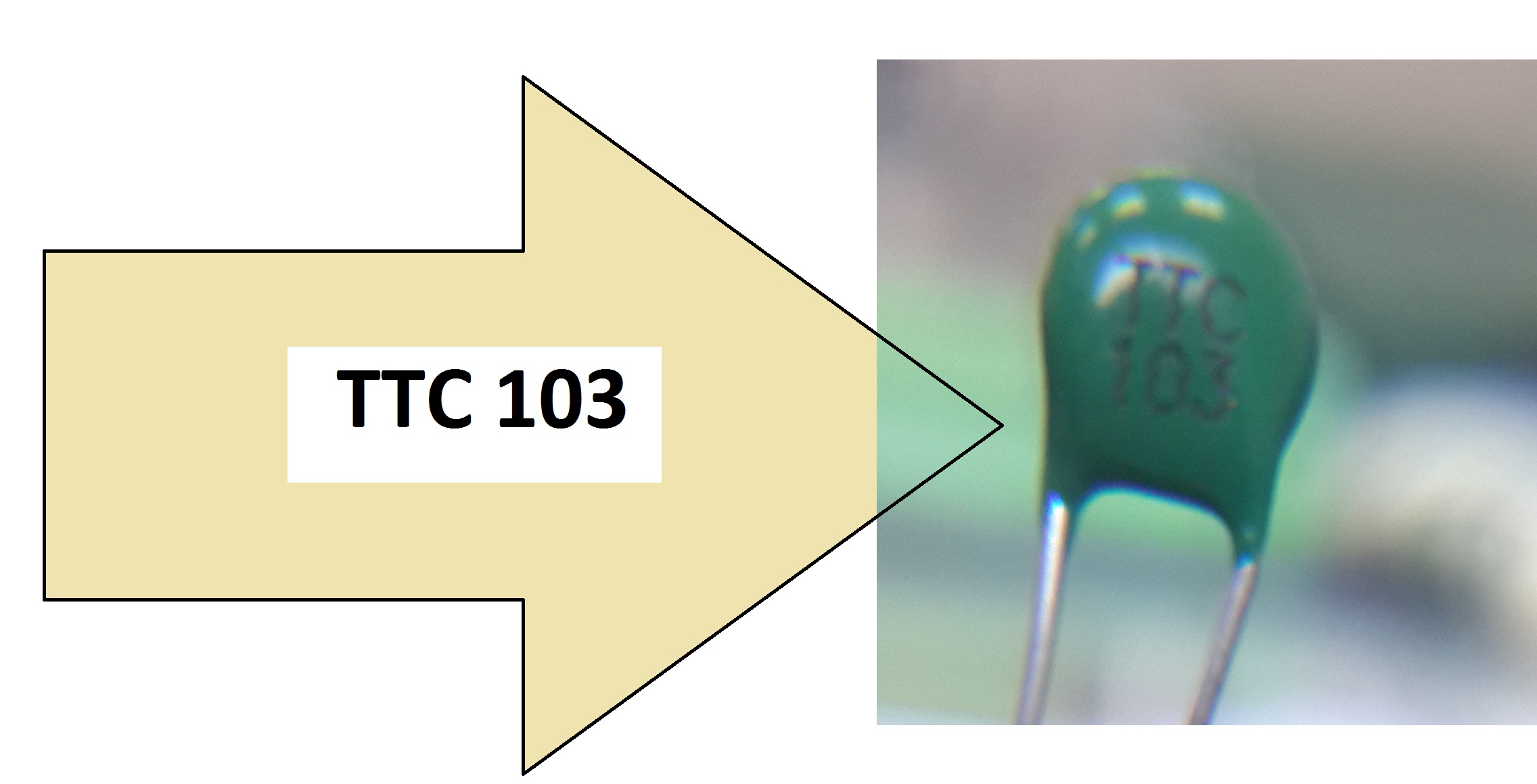

I do not know the value of the R25/85, I've just picked it thinking that 10k value is enough, attached is a photo of my NTC.

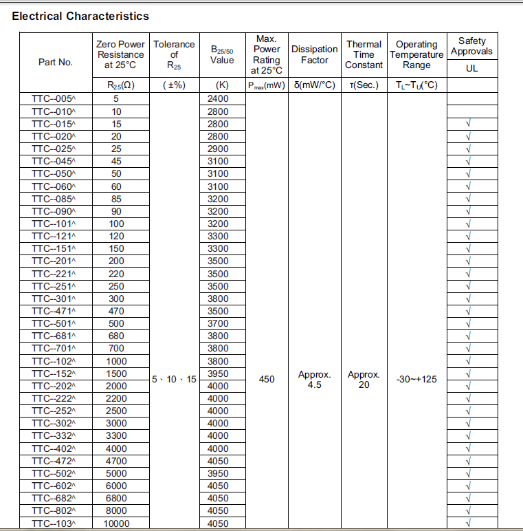

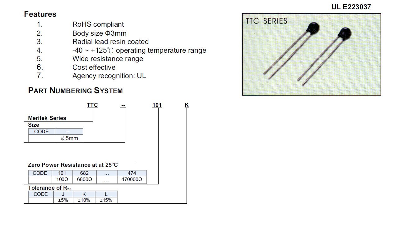

I googled for a datasheet and found one. The attached screen shoots shows its features and Electrical Characteristics.
My NTC is the last in the table.

Your simulation resistance values are way too high.
Try a 2k resistor (approx. 43C) and a 2.7K resistor (approx. 33C) for your simulations. If you followed the circuit design and values I posted, the circuit will work.
