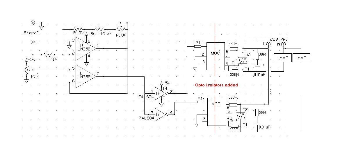

hi Omar,
This is from another thread.
Added a couple of opto-isolators
Just drop the OPA's and drive the opto's from the port.
Eric

Thank you! The schematic looks quite extensive-- but from what I see, I'd be directly playing with mains, no? I'd really like to stay away from that, I don't think I'd like to risk it, if that is okay.

Thank you for the modifications to the circuit, Eric. It is much clearer now.
