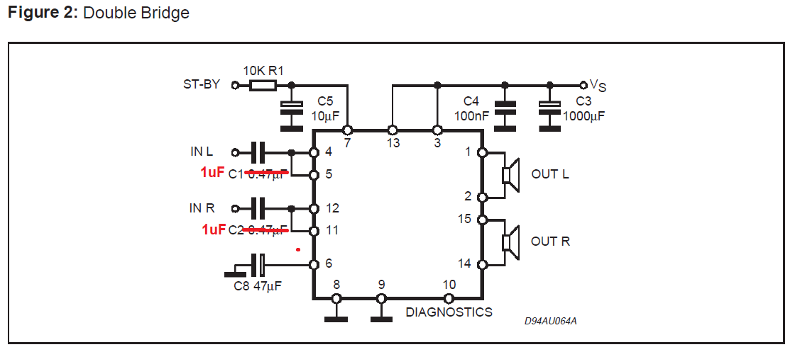

C5 seems rather low, as the preamp has a unusually low input impedance of only 12K, so this will start the bass rolling off lower than you'd like. Personally I'd probably increase the 12K to 120K, and change the feedback components accordingly, to give it a more sensible input impedance.
Yes, two of the coupling capacitors combine to noticeably reduce the low frequency response.
Suggest C5 be increased to at least 2µF and C1 be increased to at least 5µF.

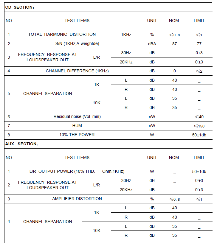

The specs you attached of the audio system shows +/-3dB at 30Hz from the amplifier output but not one word about the little woofers. The specs I found for the system says +/-6dB at 30Hz for the amplifier output.

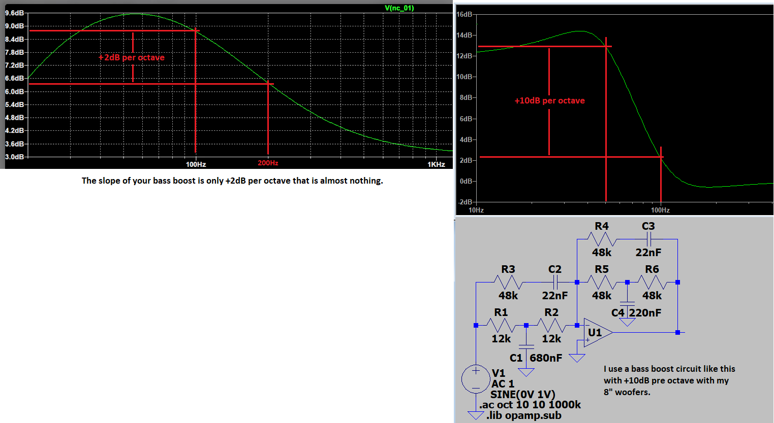

Your bass boost circuit has a slope of only +2dB per octave that is not audible. You need a +10dB slope like I use with my 8" woofers:
