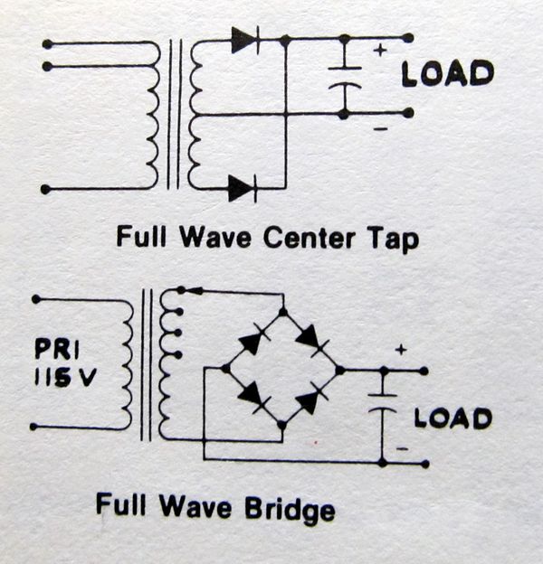

Hammond Transformers in Canada, Part Numbers:
269GX = 225-0-225 Vac @ 65 mA, and 6.3 Vac at 2.5 Amps
The 225-0-225 should be about 315 VDC when Rectified and Filtered.
I was told by Hammond manufacturering in Canada, that this Transformer Should be Available from Digikey.com.
Chemelec, you think there will be a 135V drop after the bridge rectifier and filter caps? That seems utterly ridiculous.
How do you get that 135 Volt drop?
This is a Center Tapped Transformer.
Center Tap Goes to GROUND
Than One Diode from Either Side to form Full Wave Rectification to your filter cap.
So, 225 x 1.414 = 318 Volts.
NOT a Full wave Bridge on the full output.
Ok, I see your point about it being a center-tapped transformer. Obviously there's no need for a full wave bridge rectifier in this case. But I'm not following your math. It would help me to see a circuit, sorry I'm still a noob.
He showed the circuit, its the top one and it is a full wave supply because the center tap is grounded.
