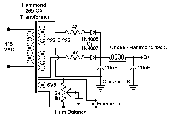

Gary (Chemelec) helped me draw this up. I still need to figure out a suitable choke, I made a barely-educated guess on the Hammond 194C. Is it overkill? And what ratings do I need on the 47 ohm resistors (2-Watt?) and the hum balancing potentiometer?

You Might be OK just using a Resistor instead of a Choke.
But a Choke will do better at lowering AC Ripple.
Yes the 194C should be OK at the 50 ma Rating.
And 2 watt resistors should also be Ok.
Even 1 watt will probably do.
You might check out some of these.
They are Smaller.
Such as these 50 mA ones: 153H, 154H or 155H.
(Even a 20 mA Choke will probably work oK in your circuit.)

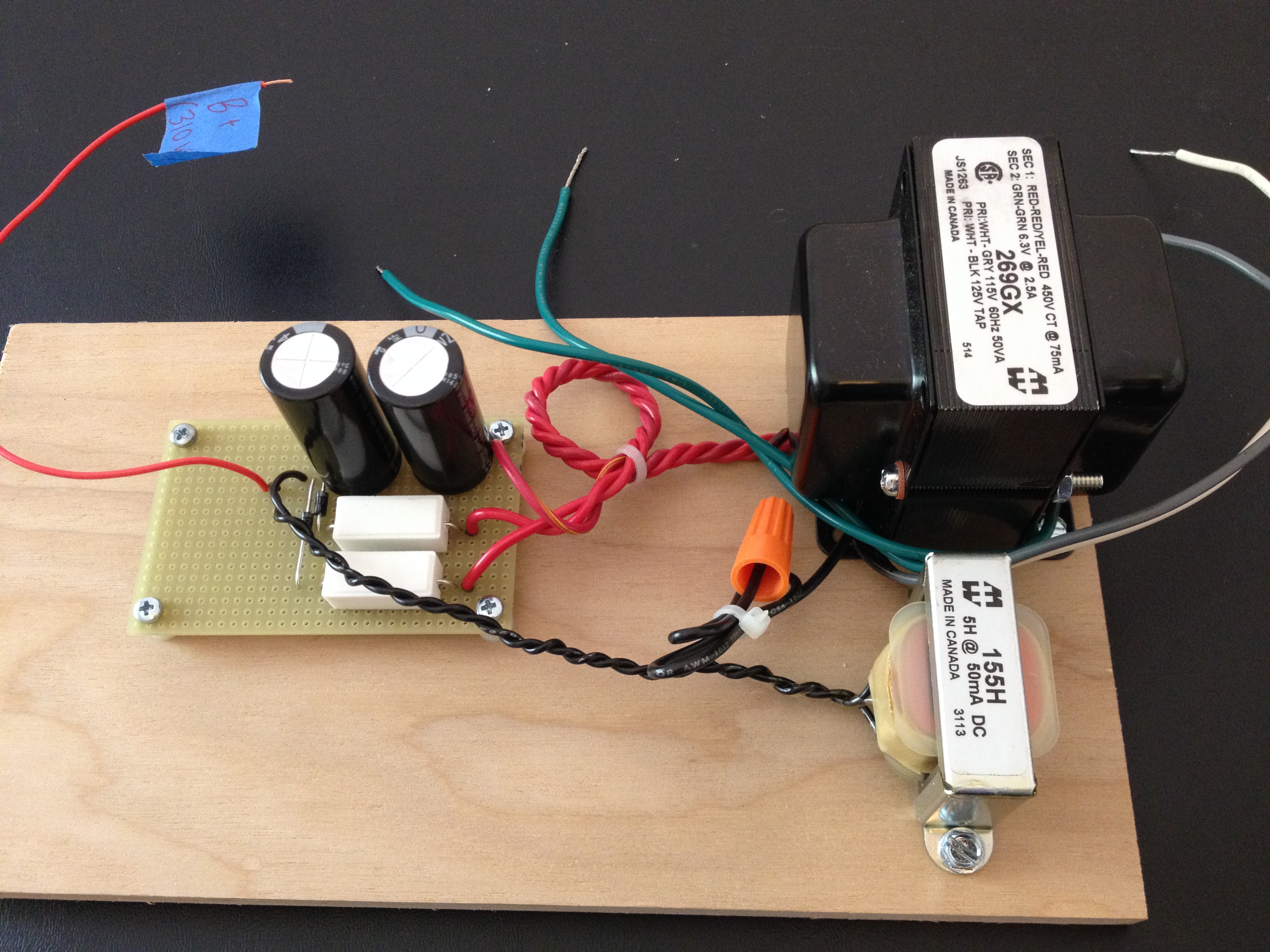

I prototyped the power supply today (finally) and it works! I'm reading 350VDC even using the 125VAC primary. We saw 380VDC with the 115AC primary. Is 350V for the B+ supply too far outside the tolerances of this circuit? If so, what's the proper way to reduce voltage in this kind of application?

For one, you need to put a load on the supply. The load will drop across the two 47 ohm resistors. At 20 mA, you won't drop much.
One way is to add a series resistor, another is the regulator I suggested and yet a third way is to use another transformer in series with the primary to drop the secondary voltage or two transformers to drop the secondary voltage because of the center tap. You could use a Bifilar wound torroid transformer though. e.g 2x18 V secondaries.
You basically have to phase them properly. A series connected transformer will either add or subtract. So, it's basically connect both primaries in parallel. Connect the secondaries in series. Measure the combined AC voltage. If too high, reverse either the primary or secondary. Then connect back to your circuit. Probably a little tough to visualize, but you end up applying a smaller voltage to the primary of the existing transformer. This really won;t work because of the 6.3 V winding. To reduce the secondary, you need two transformers. So, it's an OOPs.
If you disconnect the capacitor which connects to the junction of the diodes and the choke, you will get a much lower output voltage.
No that Voltage Should NOT be a Problem.
