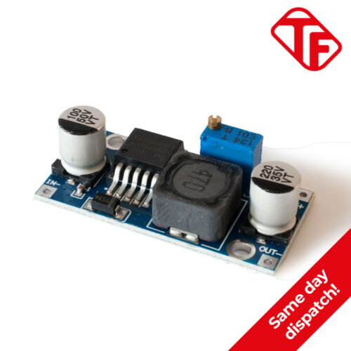

A more efficient way would be a small buck regulator module; they are very cheap and very efficient.
At eg. 100mA, the 7805 on a 24V supply has 19V across it and would be dissipating 1.9W; it would need a heatsink.
A switching regulator (such as buck converter) "translates" power, with a small inefficiency.
The input current at 24V would be a bit over 1/5th of the output current.
Examples - this style is readily available from many suppliers:
Just be sure to adjust the output to 5V before connecting it to the 5V devices - the output voltage setting could be anything, as you receive them.
