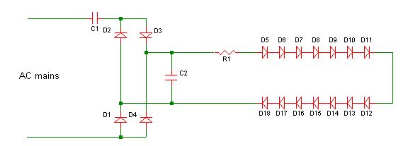

why using a transformer just see how chritmas led light are made, they are no transformer, no extra parts at all, just leds in series and maybe a capacitor or resistor. i would do it very easily, one bridge rectifer and one resistor per branch of led.

and they have to run at half capacity to make sure they do not burn out with voltage variation
Here is the basic schematic of the circuits I have been building and have had several of them running continuously now for about 6 -7 years now.
You will have to calculate the voltages and values for the two capacitors and R1 can be any where from 100 to 1K ohms.
