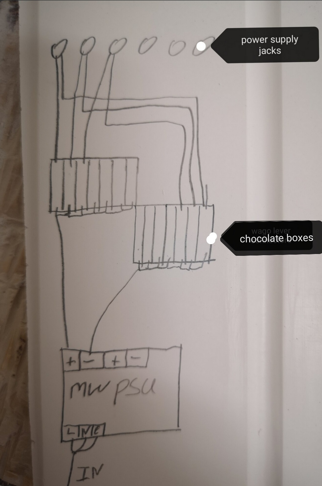

Hi all,
I'm looking for some advice on a power supply for an aquarium.
I looking to reduce to amount of power supplies I have that are plugged into 240v sockets
The equipment is all 24v DC and a max of 52W
I have got a MW HLG-320H-24B PSU
I'd like to connect 5 devices to this
I intended to use female DC jack plugs connected to the MW PSU and make male to male extension cables to connect the equipment to the PSU
I've been advised that plugging jack plugs or having a switch on each plug could cause arching
Has anyone got any advice and idea how I can achieve this without causing damage to anything
The drawing is what I'm trying to do
Any help would be great

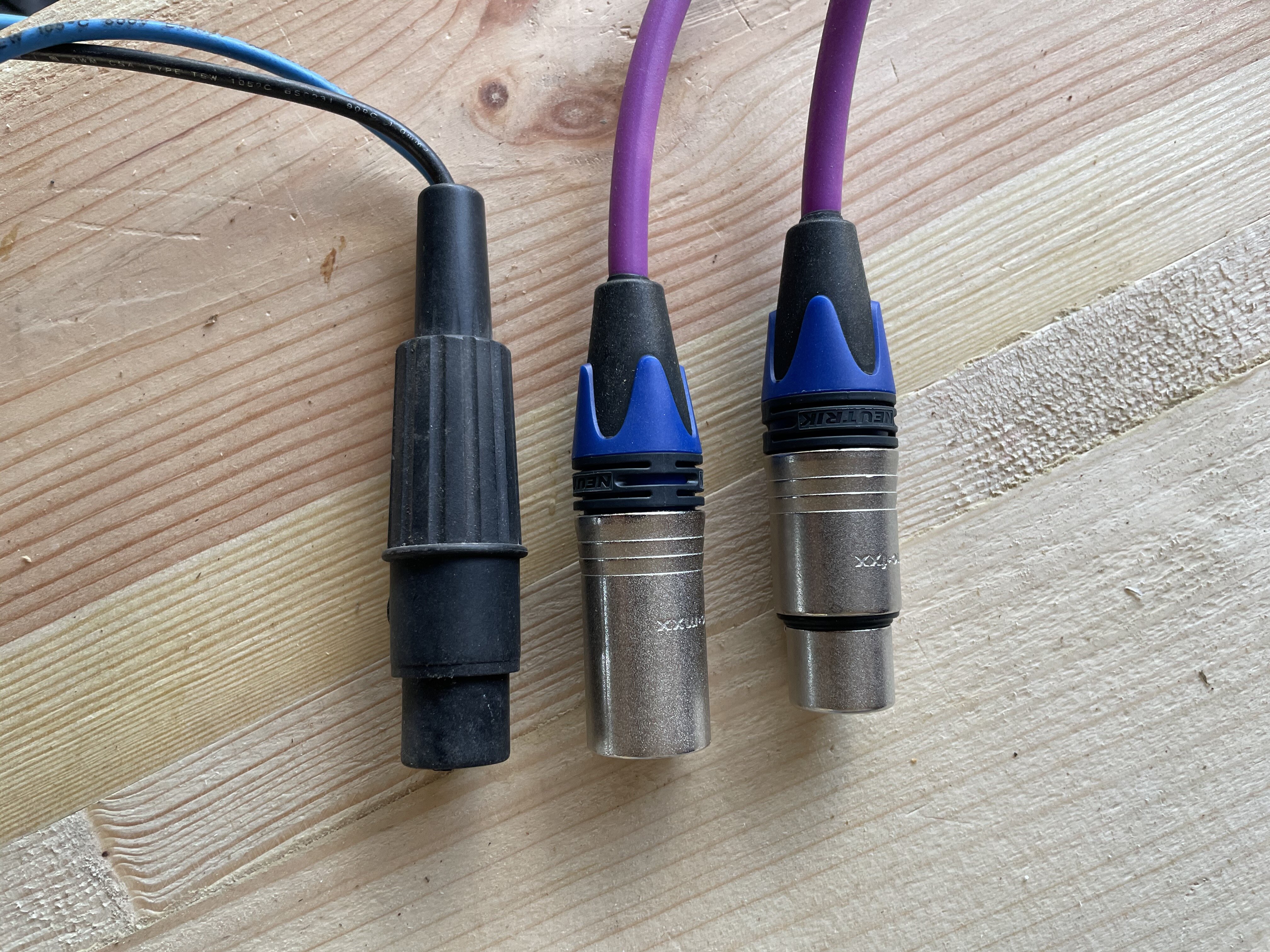

I use to use black plastic XLR 3 pin connectors to make up power distribution boxes for radio gear.
They are not particularly expensive but quite rugged and separate pins so no shorts.
Looking on ebay you can get three pin plugs and sockets for around £1 each, likely cheaper in batches.
Use pin 1 as negative and 2 as positive; that keeps it the same polarity as microphones use, on the offchance anything ever gets mixed up.
They are often used for power on professional equipment as well - good strong plugs, decent current capacity, and reasonably priced.
However, we only use metal ones, as the plastic ones are a bit too fragile for the harsh environments they get used in.

That should be fine, just try to avoid the jack being connected or disconnected while the XLR is plugged in, as a jack plug can easily short out.
I used black plastic XLRs as the type RS sold at the time were very different appearance to other XLRs, and also cheaper.
I've just dug one out, they were "Cliff" brand. They are still available but seem now rather more expensive than generic metal ones!
ps. It would probably be a good idea to add a fuse or Polyswitch type PTC thermistor in the connection to each outlet socket in the distribution box.
That way any accidental short on a jack plug won't do anything too catastrophic.
