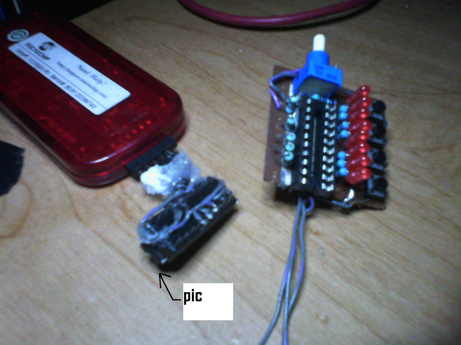

all defined leds are just for that, LED indicators this is my first time defining anything, how was that, is there better way to simplify? I would have liked to do this: #define LEDx PORTxbits.Rxx; (IN main): LEDx = 1; but mplab didnt like that.
anyway im more concerned with the if statement down there, as you can see there are 4 ports tied to buttons that hit a breakpoint when cnt++; however on my tests ports b0,a2,a3 are working ok, and like the other ports a1 is also on a button that goes to 0 when pressed. Also i have been testing port a0 in the if statement which is actually on a pot but is also never going to logic1 just like port a1. I disabled adc.h to ensure that it was not a conflict there, but still no results... and i have tested on leg of a1 with near 5v and have replaced microchip.... im sure this is rookie mistake....

.....also i seen recent questions on demoboards, i do it this way so then i dont need to plan for icsp bus, and can eject the chip for programming(when icsp clk/dat debugging conflict with the port data(not in this case today))...... just my idea of simplicity!
Maybe you are pressing the button too fast, and therefore it goes undetected (because you press the button during the delay).
You need to simplify your code until it starts working. Make a simple LED-blinker first etc.
The hardware looks also strange. Shouldn't the PIC be attached to the PCB? :)
Are you sure this is a software problem?
lol, it is assembled during testing, that was just for the photo, in image you see my circuit about to be programmed to right, and my test pic mounted on a "bug bed" with icsp pins soldered in and going to pickit on left.

So, you have pulldown resistors in the button pins, and when you press a button that pin is connected to 5v?
Also, your new code reads different ports that your first code (the if-statement is different).. what are the correct pins and how are they connected?
Simplify the code so that you read only one button. Then if that works, test each button individually.
other way around like this: 5v--resistor--picinput--button-- ground,
button pulls down,
when button is up we get 5v in circuit,

but all this talk has found something that maybe interesting, i have added code to read the ports(a0 & a1) as analog and the data is going through ok, it is reading the pot and the button values ok, but when i delete the adc stuff it does not go to digital input...
it is enough that now i can get circuit going but i wonder why i can't read digital...

yes, bc 0v is being detected regardless, even when there is actually 5v @ pin, so it doesnt matter if button is actually down or up
You are talking about simulator. You can't apply voltages to pins when simulating. Or is this an onchip-simulation/debugging (jtag.. or something)?
no simulation i know of , i am using in circuit debugging for mplab,
Ok.. You should have mentioned that also. I'm starting to waste time here with you. What else important have you not told me? Do I need to play this guessing game, or could you please tell me the setup.
sry, i was not aware, thought you meant debugging watch when you said simulation, did you see 2 posts back, about the analog stuff, i can read analog responses from the button, but i have since deleted adc.h and such, but still the inputs does not go to digital
