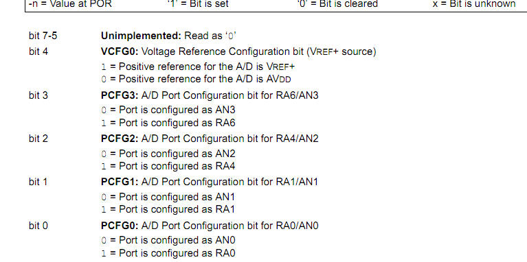

That means the datasheet is incorrect!!
The ADCON1 register used to be 1 = digital 0 = Analogue. This datasheet definitely has it the other way round.
Here are the two datasheets.... One downloaded with ISIS ( wrong) The other direct from Microchip...

i got mine while ago, usually direct from digikey, i think, but ADCON1= 0B00001110; is def what worked, i looked at my data sheet and it is identical, except they flipped the 1's & 0's for all the registers except vcfg,
crazy little bugs!
crazy little bugs! View attachment 82447
Looks like theres a Rule 3: Go to digikey, or go to the errata.
Edit: Or go to the (Errata)
