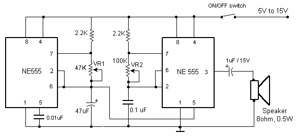

Hi I made the below siren.It worked but I'm still not satisfy with the sound.
Help me to fine tune this circuit.
Note that it has not used the pin 3 of the 1st IC.

Square waves usually don't sound better.
Boncuk
The thing is this is working speedily i need to slow a little bit.
I turn the preset but its effective in the near end.That means if I can turn the preset 180" degrees it will effect only 170" - 180".
Use 100µF instead of 47µF for the timing capacitor of the left hand timer IC.
It will change the frequency from 0.318 to 0.149Hz.
Boncuk
Hello boncuk i changed the c value to 470uf it worked with the timing that i was expected.
The txo issues are
when power up the sound is very ugly.i think this is due to the charge level of the 470uf cap.how to get a smooth sound when power up?
Still the 1st preset is effective in the near end.so its very hard to tune with a screw driver.

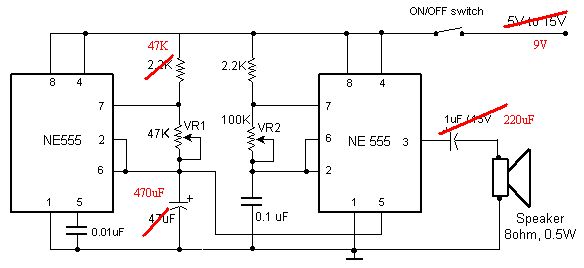

Next try 47K instead of 2.2K for the top resistor (VCC -> pin7).
470µF seems to be a very high value. Better experiment with the resistors and limit the timing cap to 100µF.

Hi I have changed the below modifications.
Please see is it ok?
When I supply it from an unregulated supply the sound is not smooth.but if I give it from a SMPS it works smoothly.
But still on first time power up the sound is very ugly.Any method to prevent this?
