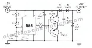

The circuit you found increases the 12VDC to 20VDC. It operates at a fairly high frequency allowing its output filter capacitor to be small. You need AC at a fairly low frequency.

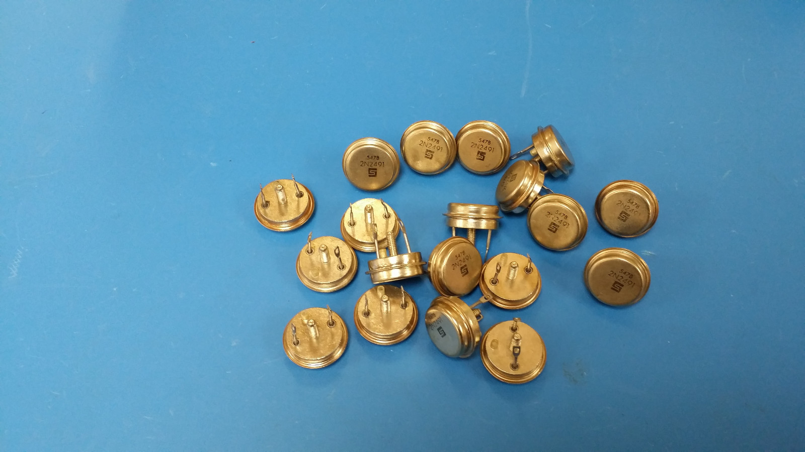

The NTE105 is a VERY old PNP germanium power transistor in a metal case with a bolt stud.
YES, I have 2 of them. The old DS501 transistors are collector items. There are several replacements, 2N441, 2N2491, NTE105, M9251, SK3012. These were used in car radios in the 1960s, rated 50v, 15a, 150w.
