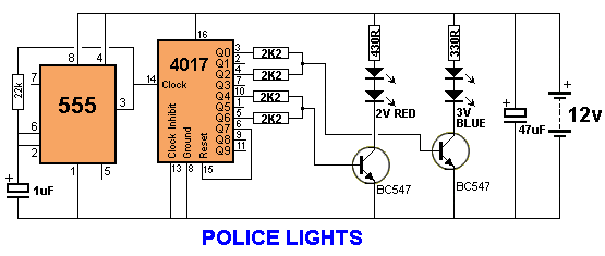

You could do it fairly easily with a 4017 and a 555.
This thread had a circuit which could work with some fixes to it. It does have errors which can be fixed if the circuit doesn't seem too complex for you. Do you want to use LEDs or light bulbs?
EDIT: The circuit in the thread/post above will work as posted if the power leads for the 4017 are added. I would also remove R4. I don't see why it is necessary.

That is another way of doing it. Did you find a schematic for the circuit in the video?
Will this design work just like in the video? How many times will each side flash?
Not exactly like the video. It will flash 3 times each side.
And how can i modify it to make it look like the one in the video. Thank you.

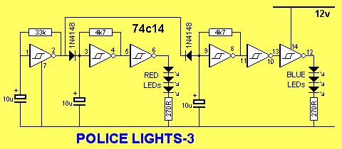

I haven't tested it, but this should work (Flash 2 times a side):

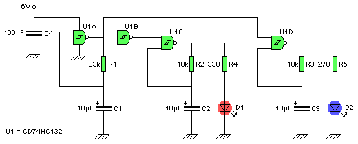

Here's an idea.
I've never built it or simulated it so I don't know how well it will work.
It uses three oscillators, two higher frequency oscillators which are gated by one lower oscillator.
The idea is to do it with one non-programmable IC. I'm sure there are other ways to do it.

You need to reverse and tie the LEDs to Vdd. Otherwise they will be ON when they aren't flashing.
Also, the first flash (Every time it switches sides) will be longer than subsequent ones, due to the cap being nearly fully charged when the section is idle. Maybe the OP doesn't mind that. Creative solution though.
Yes they're NAND gates so their outputs will be high when disabled.
You're also right about the capacitor charging problem.
I suppose I should think more before posting circuits.
It might also be possible to do a similar thing with a hex inverter: two gates could be used to make an astable with complementary outputs which would be used to control to control two other oscillators, again I haven't thought it through properly so there could be other flaws I haven't spotted.:D
Here a simple circuit that will flash 3 high bright LEDs 3 times and alternate with red and blue LEDs
