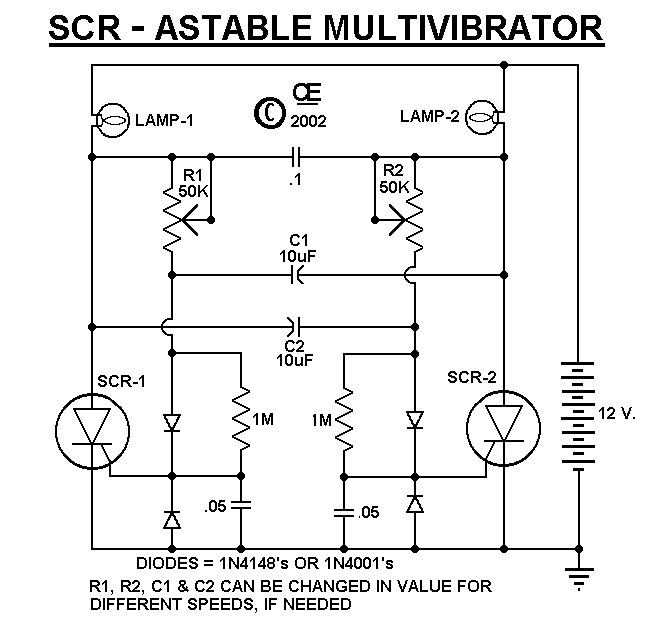

You must make the circuit very "tight" otherwise it will not oscillate. This requires the leads to be thick and the wiring to be as short as possible. This is due to the very high "cold current" of the globes - 6 to 10 times the operating current.
This "SCR" circuit works good for Alternating Flashing lights, Even car Headlights:

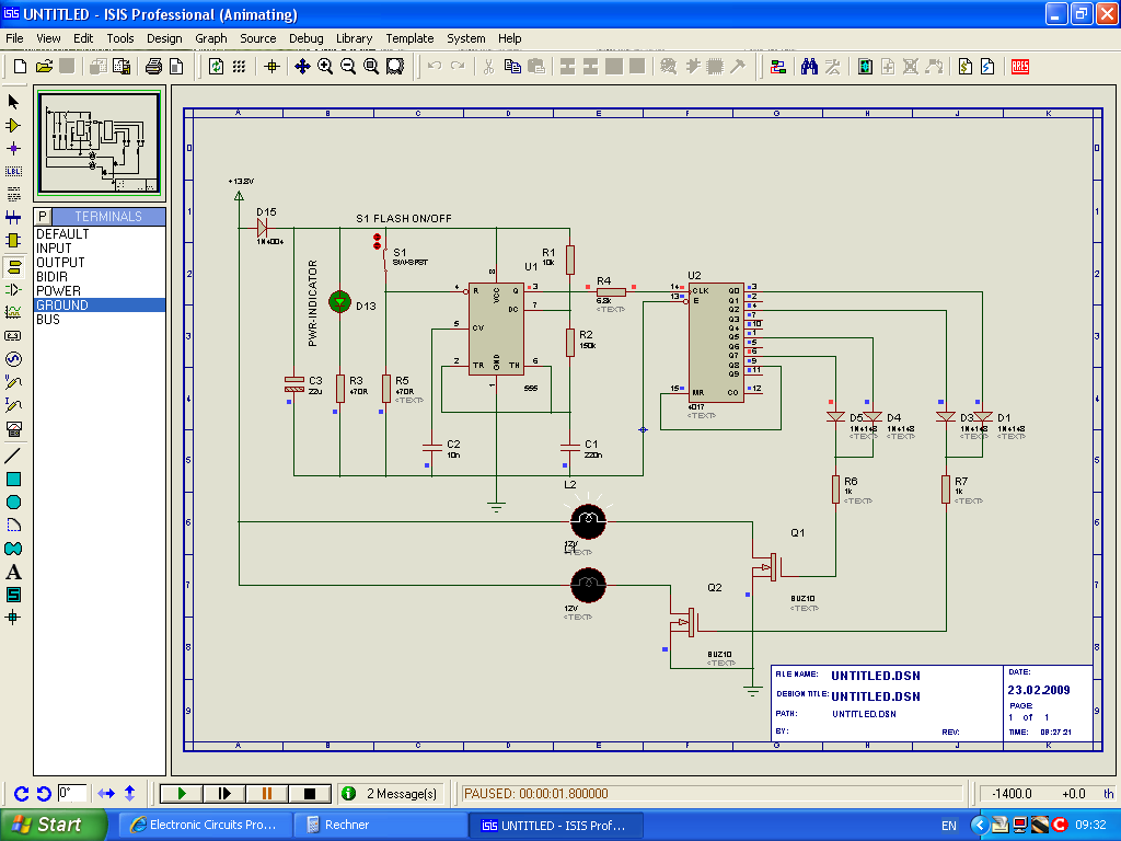

Use a timer circuit connected to a decimal counter and drive the power transistors using a diode network.
Something like that:
Lights double flash alternating at a rate of approximately 20Hz. The MosFet power transistors don't require cooling if the load doesn't exceed 3A.

This is the type of design I would really like to use. The only problem is I'm not too good with schematics. Is there a parts list for this circuit somewhere?
What did Chuck Norris' flashing headlights look like? I don't remember them from the show. '
I am pretty sure U1 in Boncuk's schematic is a 555 timer. Its very common and easy to get. U2 looks like a 4017 Decade Counter. Also very common and easy to find.
The BUZ10's are power MOSFETs. The resistors and capacitors have values next to them.
The 555 is used in astable mode. If you google "555 astable" you will get lots of pages to learn about how this works and how to adjust the speed.
The 4017 just clicks along at the speed the 555 is going, setting one pin at a time high. Pretty much
Pulse 1 from the 555 sets Q0 high and lights lamp A
pulse 2 will make Q1 go high and Q0 go back low. Nothing is hooked to Q1 so lamp A goes out
pulse 3 makes Q2 high and lamp A goes back on
then we have 2 unused pins that give a delay and then we move over to lamp B and repeat.
Q8 is hooked to the reset pin on the 4017 so we can do it all over again. This just loops over and over and over.
Make sense? The diodes block the current from going back to the low pin on the 4017

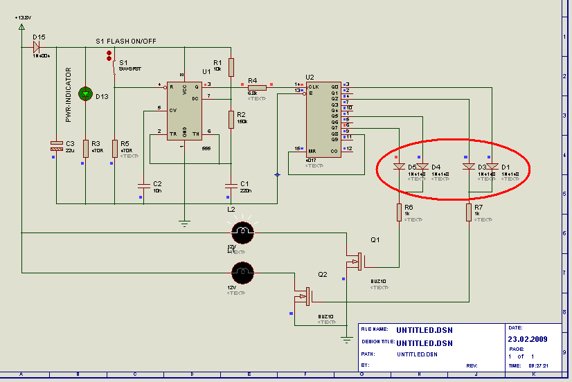

That won't work.
Both MOSFETs will stay on because the LEDs (which won't light) prevent the gat capacitance from being discharged when the IC's outputs go low.
It looks a bit too complicated. I'd just use a couple of NANDs connected as an astable driving a pair of MOSFETs via another couple of NANDs acting as a buffer. I'd use a cheap CMOS quad NAND such as the CD4011.

It's got nothing to do with the incandescents.
The LEDs he added in series with the MOSFET's gates prevent their capacitances from discharging.
If the frequency is low enough then this might not matter since the diode leakage current might discharge the capacitance there again it might not so the MOSFETs will never turn completely off.
The LEDs will also never light, well the may light for a couple of µs when it's first started but you woudnn't see that.
I think he forgot that MOSFETs have a high impdance capacitive gat and need a push-pull driver. If the MOSFETs were replaced with BJTs then it should work fine.
Aren't those just regular diodes? Maybe this dosn't even matter as an LED is also a diode?
I am in a curious mood. Is there a way to make this circuit work with the MOSFETs?
I am guessing the 4017 dosn't like voltage on a pin that is in the low state and thats why he has the diodes on series with the gates?
You couldn't simply add a pull down resistor on the gates of the MOSFETs could you?
