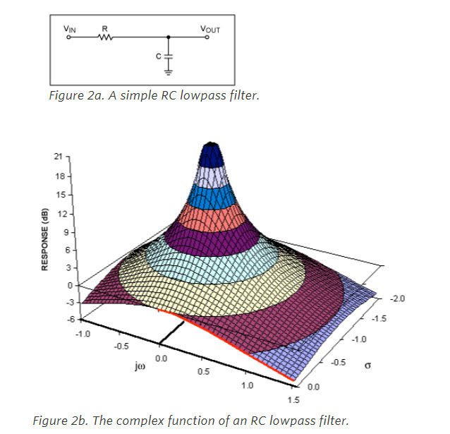

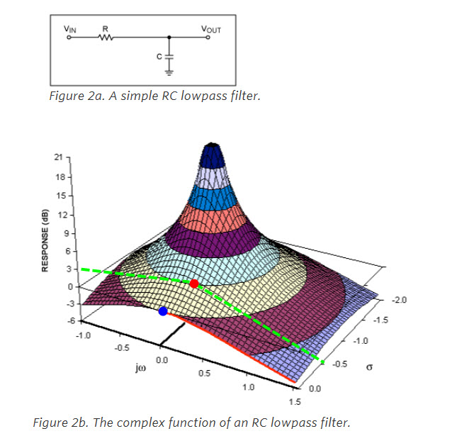

a: The following transfer function has a single pole at s=σ+jw=-1/RC. It means that σ=-1/RC and jw=0. Do I have it correct?
b: Was this plot (source) drawn assuming some specific values for "R" and "C"? I'm saying so because from the plot it looks like the pole (i.e. the response going infinite) occurs between σ=-1.5 and σ=-2 and jw=0. What do you say?
[latex]H_{C}(s)=\frac{1}{1+RCs}[/latex]
Q3:
In this plot you can see that when jw=0 (i.e. DC signal) and σ=0, the normalized response is 1 or 0 dB (the blue dot). But as σ<0, say -0.5, the response becomes, say 3. The jw is still "0" which means DC signal.
What does σ<0 mean in this case? Does it have anything to do with values of resistor and capacitor? I don't see how. If Vin=5V then I don't think changing the values of either resistor or capacitor would change the output voltage across capacitor; the output voltage would still be 5V.

[2]
That plot looks like it was made for a normalized RC time constant, therefore when lower case sigma=-1/RC we get an infinite response.
[3]
Lower case sigma would be part of the drive signal.

In my humble opinion, I think that "s" should have unit of sec^-1 because then the expression e^(s*t) would be unit-less. In order for the "s" to be dimensionless, don't you think that "w" and "σ" should have similar units?
[2]
How would define this "normalized RC time constant"?
If you read the topic "First-Order Filters" at the top in this document, it says:
"An integrator (Figure 1a) is the simplest filter mathematically, and it forms the building block for most modern integrated filters. Consider what we know intuitively about an integrator. If you apply a DC signal at the input (i.e., zero frequency), the output will describe a linear ramp that grows in amplitude until limited by the power supplies. Ignoring that limitation, the response of an integrator at zero frequency is infinite, which means that it has a pole at zero frequency. (A pole exists at any frequency for which the transfer function's value becomes infinite.)"
I understand the infinite response notion in this context of integrator but couldn't mentally picture such an infinite response in case of a series RC circuit. I believe that in case of a RC circuit, infinite response would mean a very large voltage across capacitor. Could you please help?
Okay. So, "jw" represents sinusoid drive signal and σ also represents a drive signal but I suspect it's a decaying exponential drive signal.

Hi again,
Well w is angular frequency and is equal to 2*pi*f, and since f=1/t then you could look at it as 2*pi/sec i guess, so it is scaled frequency or scaled inverse time. Officially it is radians per second.
Lower case sigma officially is in nepers per second.
I think more officially too s is in units of "complex nepers per second".
You could probably look up 'neper' and see what you can make out of it.
When we normalize something, we call that something 1. So if the plot is normalized to -1/RC, then when lower case sigma is equal to -1/RC we look at the place where sigma is equal to -1. If you like, you can just call RC=1 (the produce of R and C is 1), and that produces a specific case.
Yes i believe sigma is the exponential, either positive or negative.
For the RC filter, we have transfer function:
1/(s*R*C+1), or dividing top and bottom by 1/RC we have:
(1/RC)/(s+1/RC)
and if we call 1/RC just 'A' such that A=1/RC then we have:
A/(s+A)
Now for a sinusoidal signal we can set s=jw as i am sure you have seen many times. This gives us a complex transfer function:
A/(jw+A)
and we can vary w to find the response to various angular frequencies.
But what if we set s equal to jw+a, where a=sigma here, we now have:
A/(jw+a+A)
The plot shows that the angular frequency is zero, so this means w=0 so we have:
A/(0+a+A)
or just:
A/(a+A)
Now if we look at this we can see that if a=-A, we'll get an infinite response.
Since A=1/RC that means that if a=-1/RC then the response goes infinite. This is interesting because the time solution doesnt seem to go infinite but seems bounded.
You might also look at e^(s*t) where s is complex again: s=jw+a, where a can be plus or minus.

But there is a practical consideration to this too and that comes about because we are dealing with real valued components that change over time and temperature and sometimes even a small change can make a big difference. Let me give a very simple example...
First we have Ts=1/(s-a) with positive 'a', and the step response to this is e^(a*t)/a-1/a which we can see is an ever increasing exponential.
So if we add (s-a) in the numerator and get:
Ts=(s-a)/(s-a)
and the inverse transform of the step response for this is just 1 which is completely stable. But that only works if the numerator was the consequence of an algebraic operation because although 'a' is a constant here theoretically, in practice it is only a constant when the numerator resulted from some calculation that gave us the derivation of that numerator, not some separate physical entity. For a separate physical entity, we have to think like this instead:
Ts=(s-b)/(s-a)
where b=a, and again in theory that still results in a step response inverse transform of 1, but in practice 'a' might be 1/(R1C1) and 'b' might be 1/(R2C2), and if R1C1 is not equal exactly to R2C2 for every possible environmental extreme, we could end up with a very unstable system. So just because 'b' was set equal to 'a' by design, that doesnt mean it will be stable forever in a real life design.
