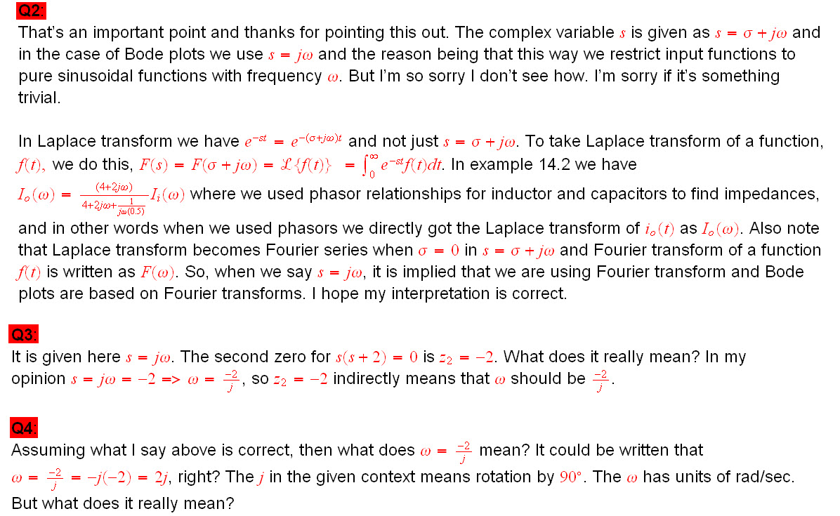

Q1:
The "s" in question is indeed the normal s=σ+jω Laplace complex frequency parameter. The whole reason for considering s=jω is that this is how we obtain our Bode plots for the system. Whenever, you see Bode plots with magnitude and phase, they are obtained from the transfer function by substituting jω in place of s. The values are complex, so we need both magnitude and phase to represent the number in polar form.
Are you implying that there are also other kinds of Bode plots which contain other information in addition to magnitude and phase?
Now, why do we care about jω? Basically, because this restricts the input functions to pure sinusoidal functions with frequency ω.
Here are Q2, Q3, and Q4. Please help me. Thank you.

Q1: No, i wasn't trying to imply that, but still it might be true. I have always seen Bode plots show magnitude and phase, but Wiki says this is "usually" the case. Perhaps there are other plots that are also called Bode plots, but generally most people imply mag/phase when they mention Bode plots.
Q2: You are interpreting correctly. The σ=0 implies Fourier transform and here the signals are pure sine waves. That's why we do Bode plots with s=jω. Doing so tells us how the system responds to sine waves of various frequencies.
Q3: No, you have it wrong. s=-2 implies that σ+jω=-2, which means σ=-2 and ω=0. We are talking about complex numbers here. You are not allowed to turn a real number into an imaginary number willy-nilly. So, in my previous post I was trying to point out that poles and zeros are typically not on the jω axis. They can be sometimes, but typically they are not.
Q4: Is not relevant since you had it wrong in Q3.

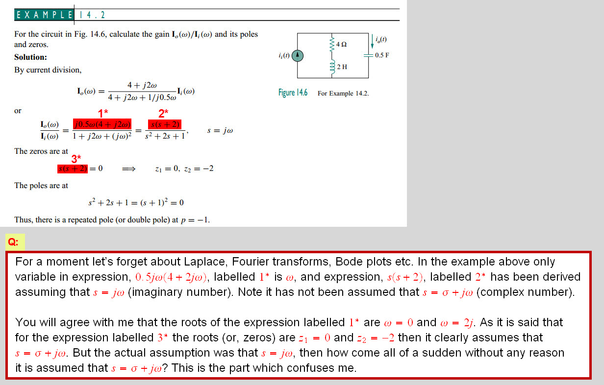

I'm still confused about Q3. I have tried to state my confusion here. Please help me. Thanks.

I'm confused at to what you have plotted in Fig. 1. The transfer function is a complex value as a function of the variable s, which is also a complex value. How can you plot a complex number versus a complex number on a 2D plot? Bode plots use only the real value ω for the input, and then use two separate plots to show magnitude (real number) and phase (real number). So, what you plotted makes no sense really. So the complex valued output is resolved into two separate real 2D plots.
On the issue of Fourier versus Laplace. The transfer function is a Laplace Transform relation. Fourier transforms are a subset of Laplace transforms. So, why are you worried about the poles and zeros which relate to the Laplace transform, when you consider Bode plots which are related to Fourier Analysis and sine waves only. Poles and zeros can be anywhere in the complex plane, but the Bode plot information comes only from the jω axis portion of the complex plane. They don't directly relate. It's not clear to my why you are trying to force them together.

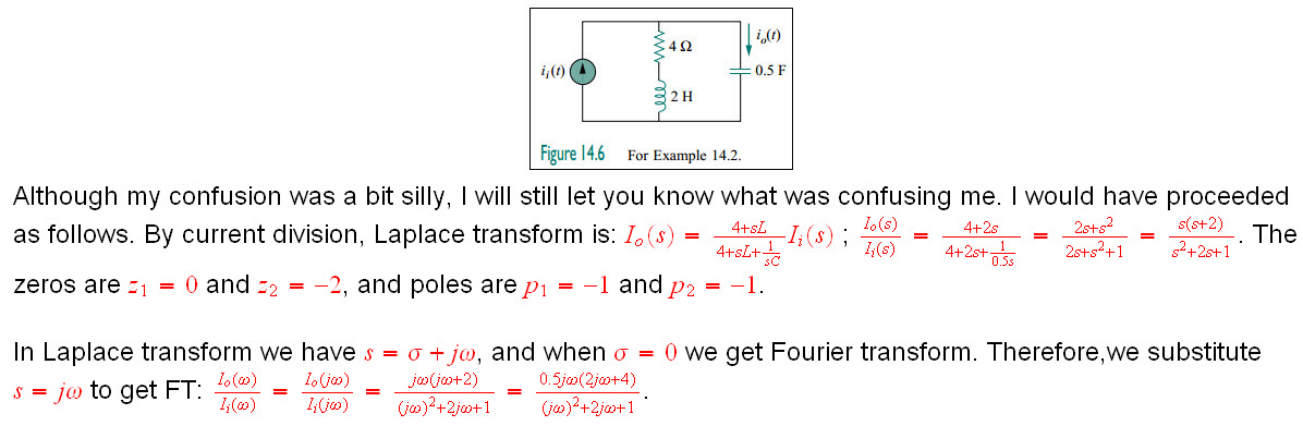

But I'm sorry because I'm still not clear. So, please bear with me. Kindly have a look here and see if you can guide me. Thanks for the patience.

s is always defined as: s = σ + jω
The zeros z = 0 and z = -2 are correct.
Location of the zeros/poles has little to do with finding out the fourier transform. The poles and zeros pretty much do define what the fourier transform looks like. Poles create "peaks" to the frequency response and if the pole happens to be on the imaginary axis, then the "peak" goes to (positive) infinity. And zeros go to negative infinity. If the pole or zero is not "spot-on" on the imaginary axis, then the peaks are "milde, or smoother".. They do not go to infinity on the Fourier plot (imaginary axis values).
Laplace transform is just an expansion of Fourier transform.
Fourier is integral of:
f(t)*e^(-jωt)
That can be expanded to Laplace; Integral of:
[f(t)*e^(-jωt)] * e^(-σt)
Combine the two exponentials and you get
f(t)*e^-(σt+jωt)
And for convenience, define s = σ+jω and you get integral of:
f(t)*e^(-st)
Which is the Laplace transform "as we know it". So, When you have Laplace transform of something, you can always find out the Fourier transform by setting σ = 0.

PG,
You said all of a sudden s=σ+jω and this confuses you. The problem is that s is always σ+jω. Always and forever. That's how it is defined. The only reason jω is substituted for s (obviously with σ=0) is to generate the Bode plot, or think about the Fourier transform. Poles and zeros always relate to s, not jω. That's why we keep saying, the Bode plot is not relevant for poles and zeros.
So, don't worry about 1* and 2* and 3* etc. All you have is the Laplace transform of h(t) to get H(s) which is the transfer function. The function H(s) defines the poles and zeros. Then, if you want the Bode plot look at H(jw), with all s values replaced by jw.
I'm probably still missing what you are looking for, but I don't know how to make it any clearer than that.
