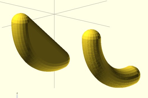

If we take a sphere on the x axis not at zero, and rotate it about the y axis, we create a toroid. We might never do this, but if we did would the hull be a doughnut or a cookie?
If we took several spheres and arranged them in a circle so they formed a discretized looking doughnut, we would then connect all the spheres together with straight line tangents (an infinite set) or simply translate each toward the other, but most importantly would this hull look more like the doughnut or more like the cookie (with straight sides)?
One more complex hull:
If we take a sphere on the x axis not at zero and rotate it only 120 degrees about y, does it create a boomerang hull or a half cookie hull?
It appears now that the hull is generated by a surface that is 'morphed' from one simple object to the next. So we end up with surfaces of rotation, of translation, etc. Alternately, any voids must be joined also but i need your feedback to determine this.
The soap bubble (or balloon) on a wire frame that has one curved part and one square part, the two parts in two different orthogonal planes.
This represents a special problem where we have to morph from one type of object to another. For example, from a sphere to a cube.
Is this type of hull allowed too or will it always be one or the other ?

Forming hulls:...
The hull of a toroid is the toroid with a flat top and bottom (no hole, or concave parts are allowed in a convex hull). The six-sphere arrangement forms the following hull (hull on left, original objects on right):
The 120 degree rotation of the sphere will cut a boomerang shape; the convex hull of it will also include the end points (the chord of the arc).
I guess the morphing between shapes will cut the hull. The interpolation will have to be between each shape and every other, I assume.

[Hull implicit]
Only the objects within the hull are defined, and the hull is implied from these objects.
[Defining the hull]
Yes, but you may have a lot of trouble defining the surface of the hull, as it can be extremely complex. Even the hull of a box and a sphere is hard (for me) to explain analytically.
