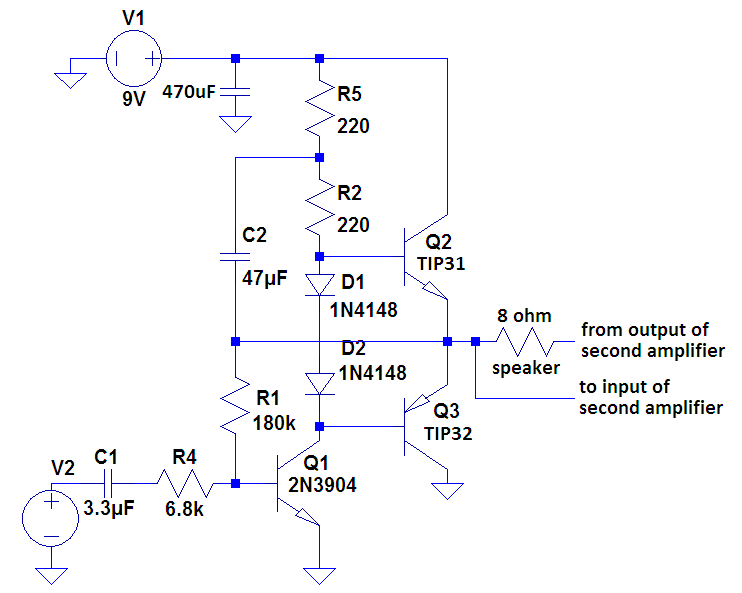

BUT two 0.8W amplifiers powered from 9V can be bridged to provide 2.8W to 3W into 8 ohms. But then the bootstrapping cannot be done with the output coupling capacitor and the speaker, instead it must be done with an additional resistor and capacitor. When two amplifiers are bridged then the output DC voltage from each amp are the same so the output coupling capacitor is not needed. A bridged amplifier uses the first amp to drive one wire of the speaker and the second amp drives the second wire of the speaker. Then the effective voltage swing is almost doubled and the currrent is also almost doubled. Double-double= 4 times the power.
Bridged amplifiers need one of them to have an inverted input. This simple amplifier inverts so the first amplifier can simply feed the input of the second amplifier.
Set the gain of the first amplifier to 10 and set the gain of the second amplifier to 1 then the total gain is 20.
3W into 8 ohms produces a peak current of 866mA which is not possible with the little transistors I showed. Use TIP31 and TIP32 power transistors for the output transistors. Their current gain is low so the current for the driver transistors must be increased.
An ordinary little 9V alkaline battery might not be able to produce peak currents of 866mA. Use six AA alkaline battery cells in series instead.
Wait a minute! YOU are supposed to design this amplifier, NOT ME so I wish you good luck and I hope I provided enough info.
Here is a hint about using a resistor and capacitor for bootstrapping and how the first amplifier and second amplifier connect together and connect to the speaker.
isnt it supposed to be, 10 to the first and 2 to the second for it to have 20 total gain?
No, because bridging doubles the gain.
You want the second amplifier to simply invert the output of the first amplifier with no gain (its gain must be 1).
the gain of the first part is -10, the gain of the second is -1. multiply those you get +10, so the output (across the speaker) is a difference of 20 because the outputs are 180 degrees out of phase. the total AC voltage between the outputs is twice what the voltage between either output and ground would be. each amplifier output stage only "sees" half of the speaker impedance (i.e. with an 8 ohm load, each output stage is effectively driving a 4 ohm load, and hypothetically the middle of the voice coil winding is a virtual ground)..... hmm maybe that's too much for you to absorb.... but i'll leave it for you to ponder anyway...

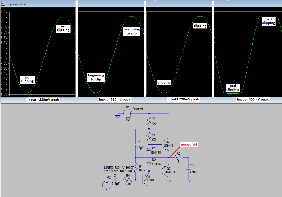

An amplifier output clips and produces severe distortion when the input level is too high which causes the output to try to go higher than it can.
Here is an example of no clipping, a little bit of clipping, more clipping and pretty bad clipping:
Nice symmetrical clipping AG!.
