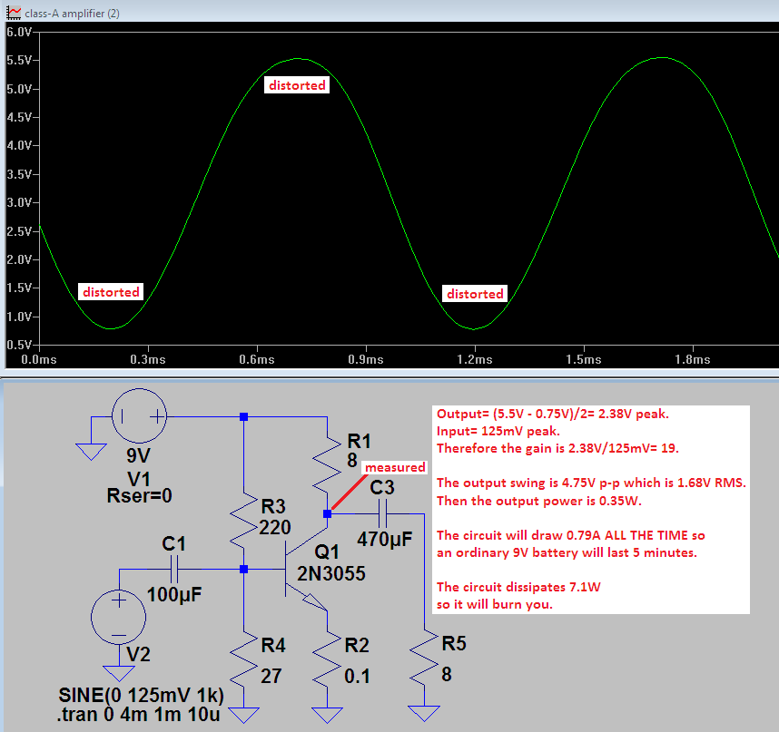

a question for all of you gentlemen, can i design a class a amplifier by just using one transistor? can i achieve a gain of 20 by using a 9v battery? if not what volts of battery should i use? thanks all of you in advance.

Yes to all - but a big NO to can it feed a speaker, and will it work as a guitar amp.
Battery voltage has no relationship to the gain of the stage, which would just be a preamp.
Here is your class-A amplifier.
It is powered from an ordinary 9V battery that lasts about 5 minutes even when the amplifier is not playing.
Its output is 0.35W RMS and is distorted.
Its gain is 19 but can be 20 if R1 is changed to 8.2 ohms.
It gets very hot (and the battery also gets hot) so it will burn you.
Its input impedance is very low so another transistor is needed to feed it. The additional transistor will also get hot and will waste the battery power more quickly.
A class-AB amplifier draws a low current when it is not playing so an ordinary 9V battery will last 24 hours but when the amplifier is playing music fairly loud the battery will last about 16 hours. Its output is about 0.6W with no distortion. When playing, it gets warm, not hot.

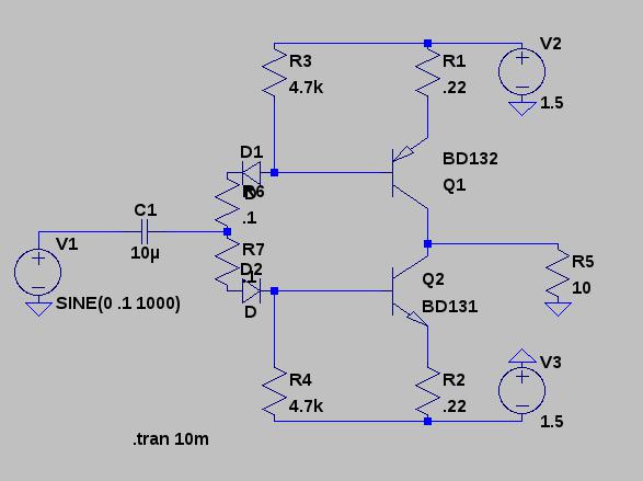

no, the Hfe isn't dependent on the collector voltage. but it does decrease with increasing collector current. this is called "beta droop" and is a cause of distortion in transistors.
there is a very old circuit that uses two transistors in a push-pull configuration that does have some gain, but it's rather crude and would need a few tweaks to get a little more power out of it. it uses two 1.5V batteries for power, i'm sure you could increase these to 3V each side without a lot of trouble. the voltage gain is around 15. the 10 ohm resistor is the speaker load, use an 8 ohm speaker there.
