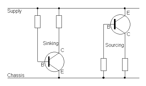

Perhaps this might help?, a diagram shorn of all distractions:

EDIT: Nigel, I do like the last diagram you posted.
Took a bit of editing! :p

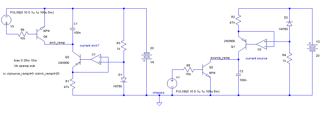

So, apparently you guys agree with the labels in the schematic below?

They are not reversed. All I did was change which rail was called "chassis". Both circuits deliver exactly the same amount of current to the load.
Nigel Goodwin said:
Yes, sink or source depends on the supply rail polarity employed.

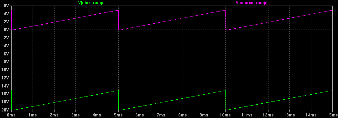

That's remarkable. That seems to mean that I can make identical ramps (except for offset voltage) with either a current source or a current sink, depending on how I define ground. Agreed?
I might be falling in a trap here?, but one way you're rapidly charging the capacitor, then slowly discharging it, the other way you're slowly charging it, then rapidly discharging it - works either way.
However, I can't help but notice your diagrams have expanded from sink and source to constant current sinks and sources.
Well, if sinking and sourcing are defined for logic gates and switching transistors, shouldn't the same definitions apply for current sources and sinks?
As I think you pointed out, I believe sink and source refer to current direction, while you believe it has to do with which rail is ground. In many systems, ground is arbitrary, and may not even be defined. Does that mean we have to label a rail before we can decide whether a switch (e.g., transistor) is sourcing or sinking? Let's say I have an ordinary TTL open collector gate. I think we agree that, if I connect it to +5V and GND, the output is sinking. Now, let's connect it to GND and -5V (emitter to -5V). If I understand you correctly, according to your way of thinking the output will now be sourcing (we could draw it upside down if you like GND to be on the bottom).
In my world, the output is still sinking. I'm getting that sinking feeling. Are you getting that sourcing feeling?:D
