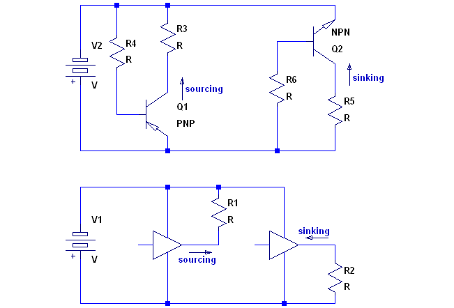

I turned the diagram upside down, as you suggested. It doesn't change anything.

Roff said:
I'm not concerned about conventional flow. I just wanted to be sure we were on the same page. And I still want to see a schematic of how you expect to get a PNP common emitter stage to sink current.

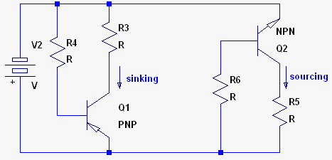

OK, here's your diagram, labelled correctly.
You have current flowing from negative to positive in the battery. How does that work?
Also, transistor current flows in the direction of the emitter arrow. You have it flowing in the opposite direction.
I use PNP for high side driving and NPN for low side driving.
Same with MOSFETs - P Channel for a high side driver and N channel for a low side driver.
Although on the odd occasion I've used a bootstrapping boost converter thingy for driving N channel FETs configured as high side drivers.
Like I said before, you're thinking conventional current flow - think electron current flow instead.
Sinking and sourcing is about low side or high side switching, polarity makes no difference.
So we weren't on the same page after all. Nevertheless, you can't make a common emitter PNP source electrons, or sink conventional current. Same for NPN, only opposite.
For common collector, the opposite holds true.
Sinking is defined as conventional current into a port, or electron flow out of a port.
