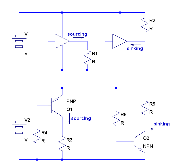

I think you are using different definitions for sourcing and sinking than I am.
EDIT: It's about direction, and not about how ground is defined.
Nigel Goodwin said:
No, exactly the same - flip your diagrams upside down - then the PNP sinks, and the NPN sources.
You can't get significant (conventional) current to flow into (sinking) the collector of a PNP, or vice-versa for an NPN.
Why are you concerned about conventional current flow?, electron current flow is just as valid - like I said earlier, don't get stuck in the 'HT rails must be positive of chassis' syndrome. A negative HT rail and sinking electron current flow is no different.
I'm not concerned about conventional flow. I just wanted to be sure we were on the same page. And I still want to see a schematic of how you expect to get a PNP common emitter stage to sink current.
