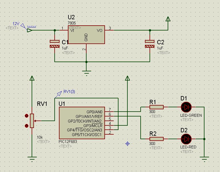

Plz help building a voltmeter on PIC12F683
Nigel Goodwin said:
You're not showing all the circuit, what about the power supply and decoupling capacitors?.
Here is the full circuit. And I did powered up the PIC with 5V on VDD (Pin 1) and Ground to CSS (Pin 8).
Try 100uF or larger (a little larger) for C2.

What is the power source? Wallwart or battery?

I'm using 12V motorcycle battery.

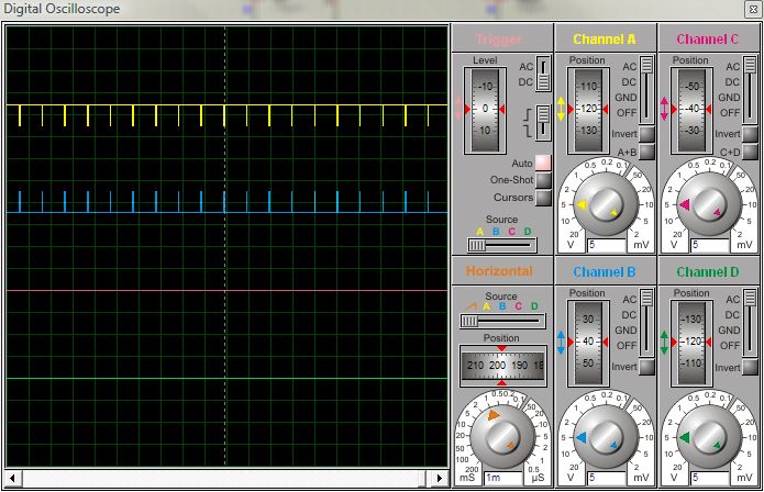

Attached is the screenshot of the oscilloscope diagram how the signal looks llike on pins 6 and 7. I don't think the problem is related to the power source.

I'm about to go postal... :mad:

Sorry, I meant 100uF on C2 only, .1 on C1. But a battery should be fine either way.
Have you actually built this? Or is it all simulation (grant it that was pretty cool)?
Did you drop the scope on the input pin and make sure it is not moving around (I see the voltage on the video says it is). Can you step through the software and get a hint where it is doing the toggle?
I load the list files sometimes with compiler code and step and many times see the problem right away.
Anyway when I have weird things happen with PICS, it is always something simple I missed. Not turning off something, MCLR, CMCON, ADCON1, noise, etc.
Do not give up, others will pop in and help you find it. I just do not see it and no time to dig out datasheet and build one.

Yes, I have it built exactly same way. Same effect.

I d'nt know this pgm language, but you must disable comparator input and AD analog input for pins GP0 and GP1 !
CMCON.0 = 1
CMCON.1 = 1
CMCON.2 = 1
ANSEL.0 = 0
ANSEL.1 = 0
Ok. Finally I made it work. Thanks for all your replies! CMCON0 was the culpit. Below is the working code.
