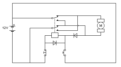

A DPDT relay can be used with a normally open and normally closed of microswitch and a couple of diodes.

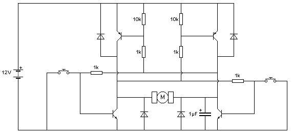

Alternatively, if you want solid state, four transistors can be made into an h-bridge which will double as a bistable flop-flop.
The trouble with this idea is the direction won't be predictable at switch on and will depend on which transistors are fastest and have the higher gain. My simulation program said that all the transistors will turn on simultaneously at power on, even when I tried altering the gains but going on previous experiance with bistables, I think this is unlikely. If it's a problem, add a capacitor across one of the switches: a 1µF electrolytic should do.

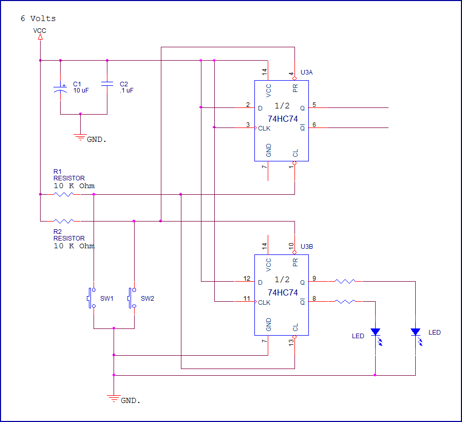

I would think about using just a simple flip flop similar to the attached drawing. Pins 5 & 6 of the 7474 would toggle a H Bridge. Since the 7474 is a dual Flip Flop the second half is used just to drive FWD and REV LEDs. I left out the LED series resistance as it would depend on the actual circuit voltage. Additionally the power pins are redundant on each half of the 7474. Anyway, given the choice I would likely use a flip flop but any number of ways to do it would work.

You don't seem convinced on the transistor bistable idea?
I simulated it again in LTSpice and it too said that all of the transistors will turn on when power is first applied, even if the gains are different but the higher gain transistors do have higher currents, as I'd expect. In real life I'd imagine that the transistors carrying the highest current would heat up, causing them to conduct more, leading to a safe, stable state with the motor running in either one direction or the other but as I've not built the circuit I wouldn't put it to chance, it's possible all the transistors will meltdown.
Fortunately, there's a very simple solution: connect a small capacitor across one of the bottom transistors to ensure the motor always starts in one direction only; this is probably desirable anyway so I'd strongly recommend it, so much so, I've added it to the original schematic.
An IC flip-flop would probably be safer in that it's been proven to work, although it's a lot of extra parts, especially as this is running from 12V so a regulator is required.
I'd suggest trying my idea with a dummy load resistor, try 220R, and temporarily put a resistor in series with the whole circuit to protect the transistor, if the worst happens, try 15R. Then when you've got it working, replace the dummy load with the motor and remove the series resistor and replace with a 500mA fuse, yes it's always a good idea to fuse circuits like this.
