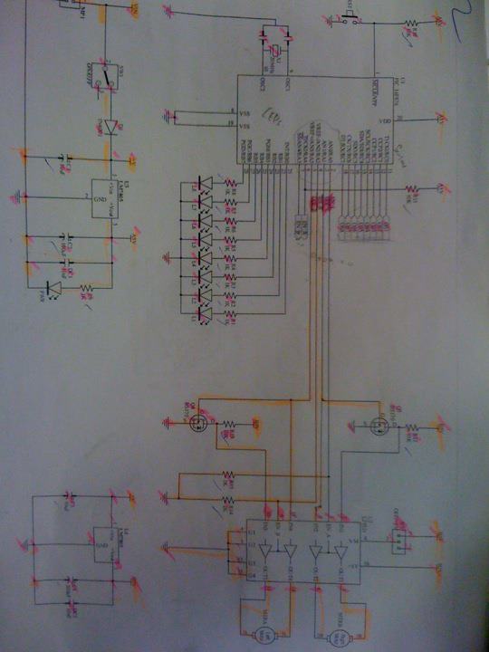

hi guys, i doing my final year project and i am really stuck with the programming. i am using Mplab to write the program.
The buggy is a 2 wheel buggy which has 4 top sensors which are infra red and 4 btm sensors which are infra red as well.
The top sensors are to detect obstacles which then allow the motor to move. The btm sensors will read the colours which are black and white. The platform which the buggy is running on is a dart board like black and white spiral. So when all 4 btm sensors sense black in the middle of the spiral dart like platform it will stop. so far i am abit to run the Leds. However whenever i try to test my buggy forward or back using the lookup table it doesnt move. The proto type is prefectly fine.
I am really stump of what to do now. I keep trying to change the lookup table but i think that its fine. I am trying to fix the btm sensors of my program first. My btm sensors are able to detect and light up the leds but they are not able to move the motor. Please help guys please. Thanks. I have uploaded a picture of my circuit board. IF u guys need more information please tell me thanks so much
So... it sounds like you can't get the motors to run?
Before attempting things like lookup tables, it's a smart idea to just send a byte to the port to see if you can get those H-bridges to run the motors. Do that, check the voltage on the port pins. Hard to tell from that fuzzy schematic, but it looks like you are using port A... on a... what, PIC18? Port A is multiplexed with the A/D converter, the problem may be in the port configuration bits.
yes i cant get the motor to run. i' have got a feeling that its my look up table that is the problem, but i have double checked it and its fine. Yes it is a PIC18. hmm i try and work on my program more. then i will get back to you. But this is what i have done so far.

i have not done the pulse width convertor but without it the buggy should still be able to move
I see a couple of problems -
You "goto" SENSOR_CHK, but SENSOR_CHK has a "return" statement in it. You only return from a routine you "call", not "goto".
Also, "movfw" isn't a pic instruction I know - do you mean "movwf" or "movff"?
Like I said earlier - before trying to debug the lookup table, just send one byte to the motor drive port to find out if the motors will turn at all. Try putting something like this at the very top of the "Main Program":
                movlw    b'00111010'
                movff    WREG, PORTA
Here            goto     Here
All it will do is send a byte out the motor drive port, but this will help you find out if the motor will run at all, and allow you to check the port pins with a meter.
My motor started moving already! As for movfw its move file to W its a code that my teachers taught me. Thanks! I happen to found out that my wires were not soldered in properly. it was a careless mistake on my part. I am really happy that my motor started moving now for the real programming :( Can i ask you if i have any more questions in the coming weeks?
And what about that "return" statement in SENSOR_CHK ?
No, it returns from a SUBROUTINE - the ones that you "call", not "goto". And it will cause problems if you use outside a subroutine, because it loads the program counter and stack registers.
With this you probably want to replace that "return" with a "goto Start". This makes a loop. Programmers call this loop the "main driver loop". From this loop you call your subroutines, like SENSE. SENSE returns to the loop, at the next instruction after the "call".
Oh ya so when i goto start it will loop through the whole program! thanks! now i better get started on writing the real part of the program. Connect the motor the the 4 top and 4 bottom sensors! :)
You got it, good luck and happy robotting.

When the first sensor is on, it lights the indicator, otherwise it is off. You then try this with each of the 4 sensors - it is not enough to check voltages, you must make sure the processor can read the sensors because sometimes a port is not initialized correctly. The indicator led will also help find other problems, it can help debugging the lookup table and a thousand other things.
hmm! Yes i got a red and yellow led, 4 red 4 yellow leds. . check_loop is for checking the sensor , which is similar to my sensor check right?
what about sensor_on? sorry i am really not very good with this programming. But i have check all my sensors, which are all working fine. I checked it by using this code
test
;movfw PORTC
;movwf PORTB
;call SENSOR_CHK
;goto test
i think i explained my buggy abit wrongly. its a buggy, 2 wheel. 2 motor. 4 infra red sensor which are the top, and 4 line sensor which are the bottom to sense black or white.
if it sense all black it will stop moving. Is my codes which i have done so far correct? As in i am quite sure there are some minor or maybe even major problems, but i just cant find them
A semicolon comments out the rest of the line. When the compiler hits a ";" it will stop compiling. They are only used for comments in this kind of assembly program.
