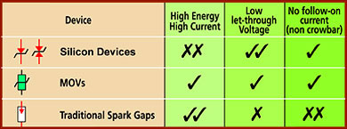

You can also use a MOV interchange to GT900...
See the table the difference between MOV and SGP...
