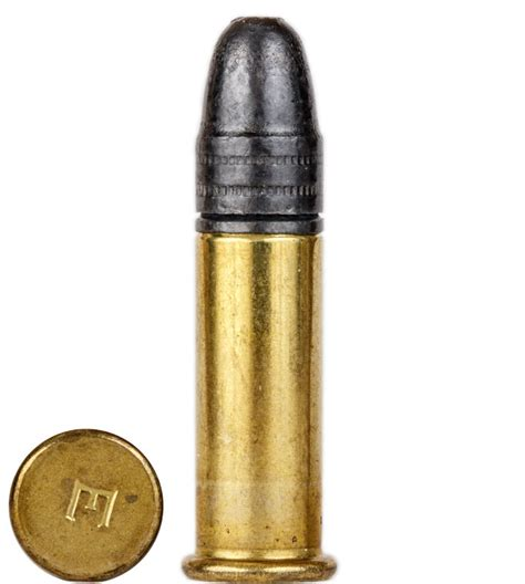

Mythbusters did article on people using .22 rounds as fuses!
Definitely not a good idea.
