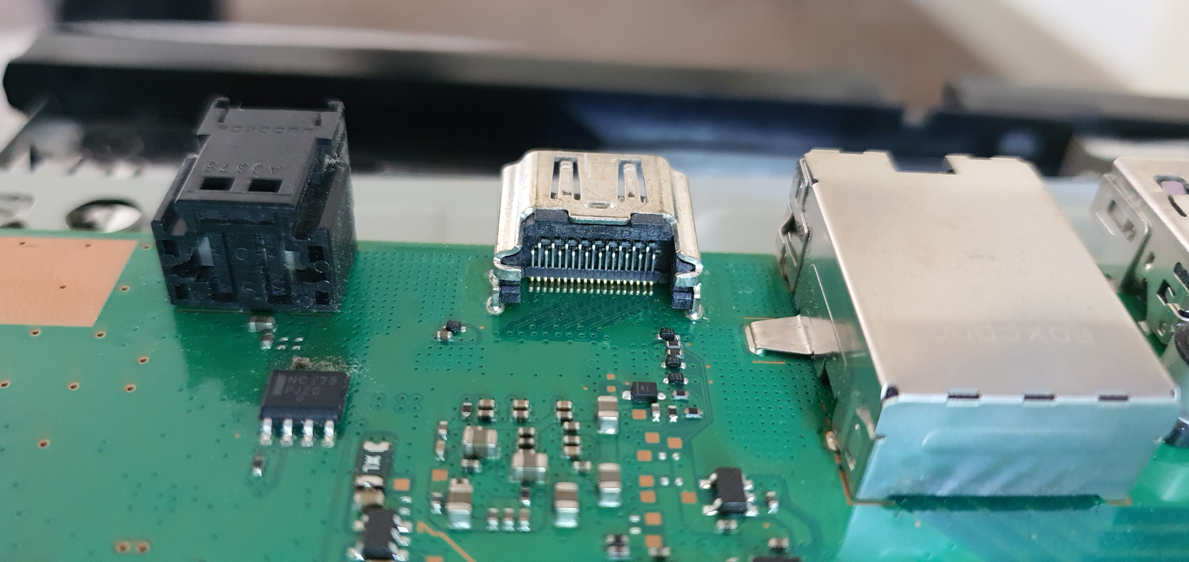

I'm trying to mend a PS4 which shows no signal, originally I thought the it was the HDMI port as it had to be plugged in a certain way or else the picture would flicker on and off. However on opening it up all the pins and the Jack look great, It cost £30 for a CI chip, so I'm wondering what to do now??

It still could be the HDMI port. I've replaced dozens of those stupid connector ports, it might look good but chances are it isn't. Especially with the wiggling cable thing. Do you know how to surface mount solder?
It seems pretty solid, I'm not really that adept to electronics though. But I've been watching YouTube instructional videos. Seems like it might be very fiddly and my eyes aren't the best now. But I have a heat gun, a solder iron and some thermal paste.
i seem to remember that early playstation and xbox consoles had problems with the video chip breaking solder connections under the chip, and many times the solution was to reheat the chip with a heat gun...
