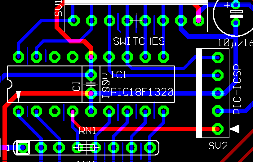

Hi Vizier87,
here's how to bypass your PIC. (Solder the cap on the bottom directly to the supply pins.)
It's almost as good as an IC socket with built in bypass cap.
Boncuk
