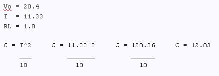

Holly Cow, am I screwing up Ohm's Law here - I'm a software guy with a little bit of electronics knowledge.

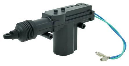

These are aftermarket or 'General' purpose Door Lock Motor / Actuators for retrofitting older cars with manual plunger style mechanisms, measuring in at 1.8 Ohms, and the Drill Battery fully charged reads 20.4 Volts.
I = 20.4 / 1.8 = 11.33
I mean I tried grabbing hold of the darn thing just to see how strong it was, and the plunger ripped right out of my fingers.
11 Amps seemed really high to me, but it certainly matches up with all the sparking going on along with that wonderful ozone smell. I tried to measure the current draw, but the circuit is only energized for a blink of an eye, and well my Toys-R-Us meter can't catch such a fast current spike.
It is!
The running current of a motor depends on its speed and load; the only relation to DC resistance is that the current will be somewhat lower than that provides for when it is running.
The resistive current is the "stall current" with no rotation.
As an example, I have a little 12V motor here that draws 5A when held stationary (stall current) but less than 100mA when running freely.
With yours, the current at the instant the relay switches off is the figure you need to base the calculations on.

What brand/model car did that thing come from?
Oh it's not for any specific make or model, it's a generic electric door lock actuator mostly used on older cars to convert manual locks to automatic ones. I had a bunch of them laying around, but you can buy them new on eBay for like 5 bucks. Unfortunately the specs for them don't seem to match with what I'm seeing or measuring.
Could be that the ones I have are a different version, not really sure.

The 2.22A value in the ebay listing is more reasonable for operating current, but it all depends how they work internally.

Here's a picture of a similar lock mechanism I brought at a junk store.
At 12 volts, it draws close to 2 amps.
At 18 volts, my current-limited supply at 5 amps shuts it down.
