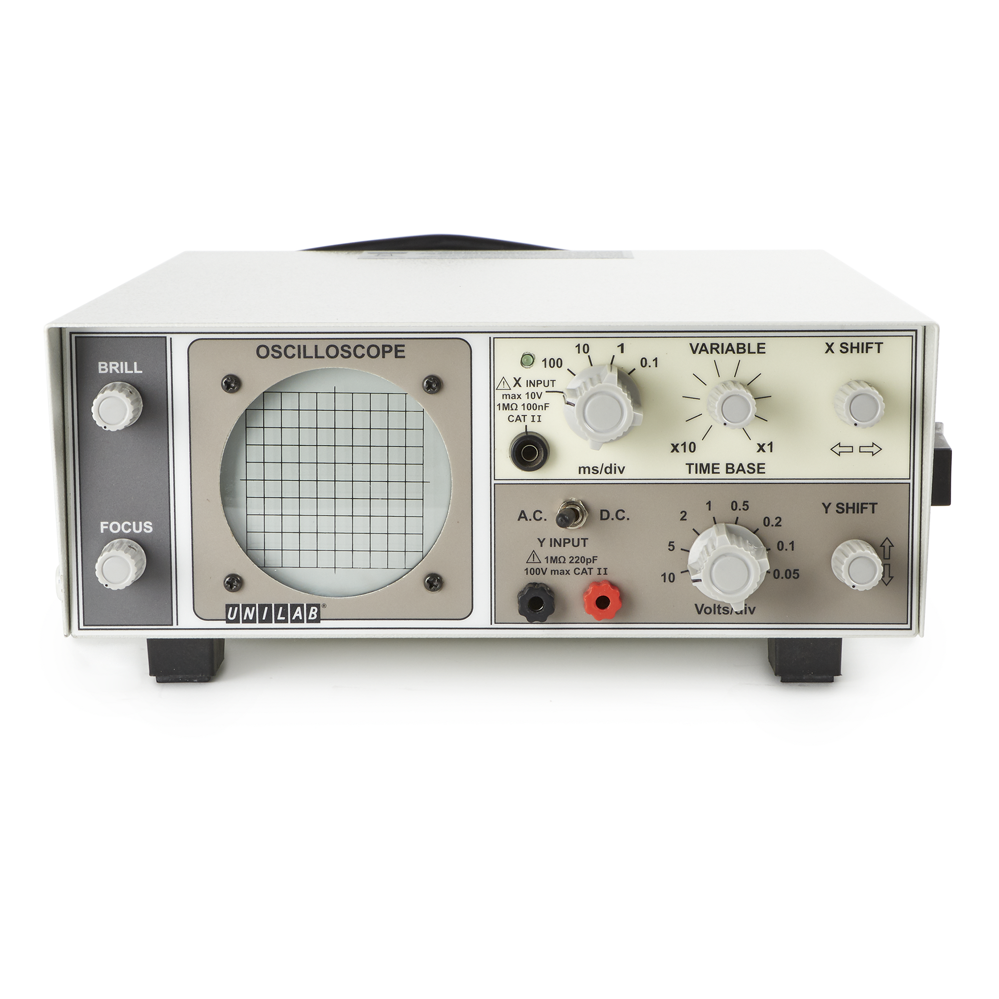

I still have 'my first 'scope', its even more basic, yours looks Ok for this kind of thing.
Take care though if you stuff full back emf from a large coil up the input you might blow the Y amp.

I still have 'my first 'scope', its even more basic.
Kind of curious, any chance you've got a picture of it?

These are still for sale and they look at lot like yours:
Its a philps harris, mine is a unilab, they became philips harris I think.
Reminds me of all the 555 and 741 circuits I used to blow up back in the old days not knowing what I was doing, nothings changed just the price of the parts.
No bnc's, just bannana's, and the knobs are not switches just pots, there is no calibration just twist & tune.
The 'scope has developed a weird thing where the trace moves up & down a little and will not x shift all the way, power supply electrolytics no doubt.
It does look a lot like mine, even the color scheme matches.
