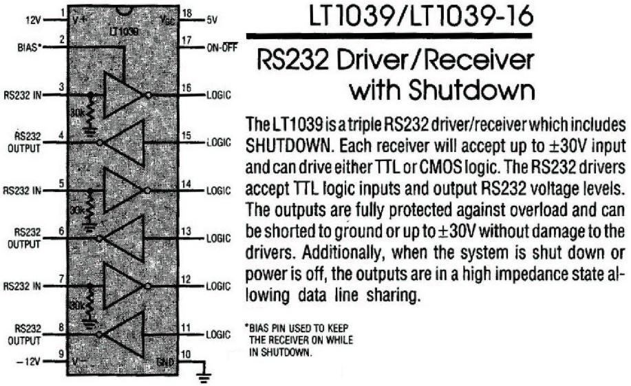

pin out for an rs232 tx/rx chip
Do You think about LT1039 from Linear Tech?
