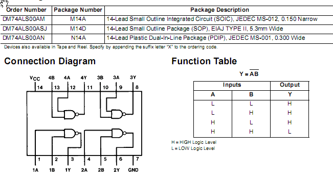

Does anyone know where I can find the pin configuration for a Quad 2 i/p NAND chip, SN74ALS00N? Any help would be greatly appreciated.
