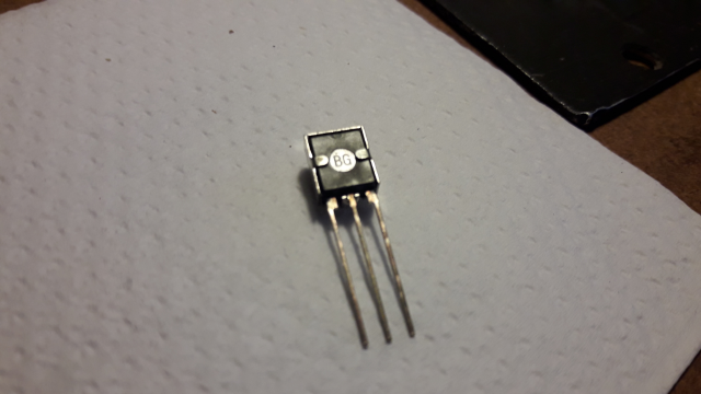

I bought this IR receiver (is it?) many many years ago. Always believed I had the datasheet but no. Not even sure if it is for 38 KHz.
No other marking than the "BG" in the back.
I could try to identify +V and GND pins with a DMM but I would prefer not to risk damaging it.
A Google search did not give any meaningful result.
Help will be appreciated.
They are usually pretty standard connections (and the frequency seems to make sod all difference - we only ever kept one type for service replacements).
This one looks pretty easy - the metal screen is connected to the middle pin, so obviously ground. So only two options, I suggest you try the one below.
Yes the middle is soldered to the screen.
Gracias Nigel.

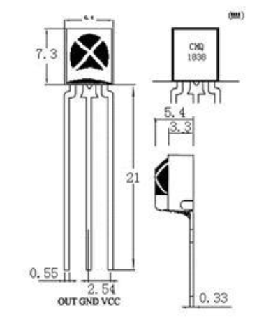

You may want to check out the little testing circuit in this article (note also the different pin outs with GND on pin 2).
For eventual future reference.
The guy that sold them to me on the counter, did not hesitate: IRM 8601 M2

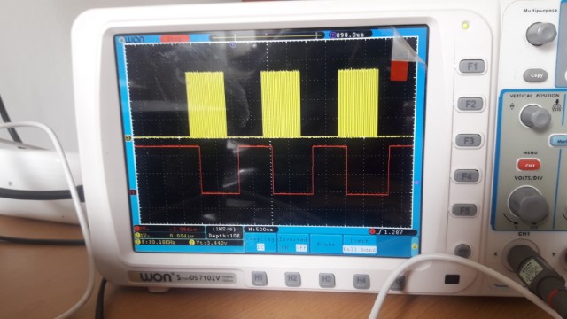

Tested today successfully.
