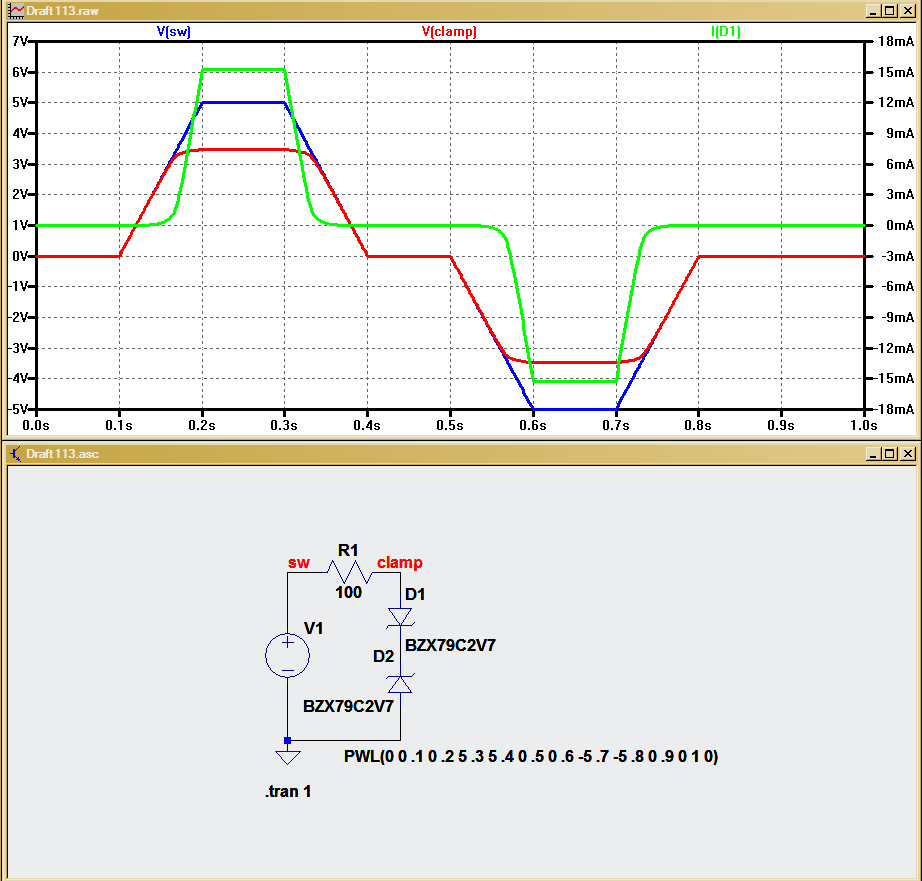

hi Al,
You require a transistor driver between the PIC and the Relay
Hi Eric,
I had hoped to do this without what would end up being just about an H-Bridge. If I had any of the motor driver ICs I would maybe have gone down a route using those, but its one of the things I have never had.
Do you think its worth a try with just the pic, I have a few of them and if one got fried I wouldn't be too upset. If I could just get the snubbers right.
Al
hi Al,
Choose zener diodes just above the working voltage of the PIC.
Look at this image.
Edit:
Testing
Will this work?
Hi guys,
Just wondered if this way of snubbing would work for the relay?
If I substituted the relay for the motor in the diagram below.
I must admit I still don't understand the Zener method you drew Eric and won't there be loss due to both the diodes and the resistor?
Anyway have a look at this and advise please.
Al
