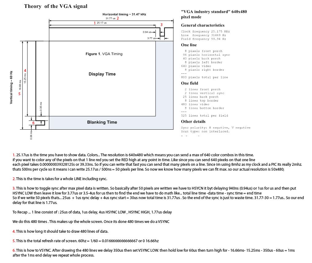

ok this is how i think it work. Sounds correct to me.
vga-jpg.47253

I Made a new image hope it will help everyone who wants to implement VGA. It should be clearer now:
atomvga-jpg.47266
