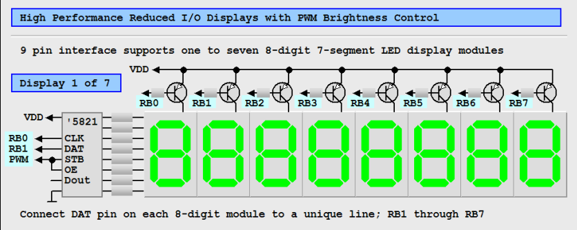

You can see we're using a lot of pins at this point so you might consider using a different driver IC with the common anode LED configuration. The Micrel MIC5821 or the pin-for-pin compatible Allegro A6821 is an 8-bit serial to parallel sinking driver with a 3 pin interface (Data, Clock, and Strobe). Here's a full brightness design that uses 9 I/O pins.
matrix-display-9-pin-7-seg-png.12392
In this design PORTB is used as a column driver bus when the Strobe/OE pins are low (display on) and as a data bus to load the driver shift register when the Strobe/OE pins are high (display off). Simply blank the display at the beginning of each "scan" interrupt by taking Strobe/OE high, load new data into the SR, reset the PORTB column bus for the next column, and finally turn the display back on by taking Strobe/OE low. This only takes a few microseconds in the ISR.
You can also setup the PIC PWM module with a period equal to the column "scan" interval and drive the MIC5821 Strobe/OE pins directly from the PWM CCP1 pin output. You'll need a minimum PWM duty cycle of 5% or so to insure that you have time at the beginning of each interrupt cycle to load the SR while the display is off. Adjusting the PWM duty cycle from 5% to 100% will take the display from full brightness to black, respectively.
While these examples use 7-segment displays, I'm sure you realize you can use discrete LEDs or Bar/Graph LEDs or 8x8 matrix modules instead. And the "high performance" designs also scale up or down quite nicely.

Peter,
I'm still not sure a '4017 or a '154 would be a good choice. Neither can be used to sink or source enough current to a multiplexed display without adding driver transistors and in the case of the '154 you really don't want to "scan" more than about 8 columns as the duty cycle is much too low and the pulse current requirements are way too high.
In all fairness I should mention that some of the direct drive low brightness designs might work well for your application too.

Mike, your design works very well thank you!
Using an 8x8 matrix ... +v powered by the PICs B port and GNDs are switched on and off with a 4017 decade counter.
8 npn BJT are used to increase GND current!
All I need to do know is find the right UDN chip to replace the transistors which are switches on and off by the 4017
You want a ULN2803 sinking driver. It'll accept the active high output from the 4017 and sink current to ground on your columns.
