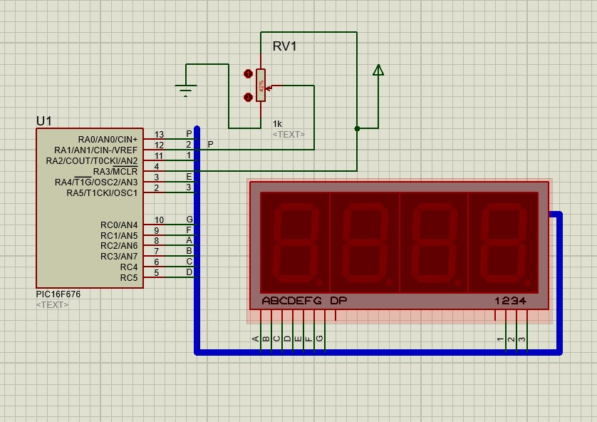

this is the PCB I already designed to my needs..:nailbiting:
I don't know where you got that code from, but its rubbish...

This will yield 0 if the voltage is stable...
Assume 8 bit reading... 200 x (mid voltage, say 2,5v) we get 25400.. So max and min will be the same (ish)..
result = resmax - resmin; or result = 25400-25400... Oh a big fat 0.. so unless you ground your probes before every 200 samples you get zilch..
I compiled it with XC8 and the code works fine...
Change the faulty line to:-
result = resmin + (resmax - resmin) / 2;
I got this circuit from a Russian site... and eassy designing of PCB, I interchange some connection of the IC to the display.
I already made 3 PCB for my own purpose... But it not work. Its my fault.. I need to check the edited schematic first, I know.

I converted this to XC8... Using the PCB you supplied
Here's the connections:- No resistors on the drawing as they are not needed for simulation, and the display is a 4 way but ho-hum..
Here is the code... It runs on those connections ripped from your PCB picture..

**** REMEMBER *** I changed this for DC measurement... Your original is for AC
Hello Ian Rogers
Can you please make the code working I already Given? Its most suitable for the PCB, I made..
I will upload the code and schematic for the same again...
Hope your help again...

Oh Yeah!! Why don't I go all out and install MikroE for pic just to get you going!!! Do you not think I would have done that rather than spend over 2 hours converting to a better compiler just for someone else in another corner of the world!!!
Tell you what!! Why don't I reprint your PCB's for free!!!
I made that code work for your PCB.... I don't know why I bothered....
