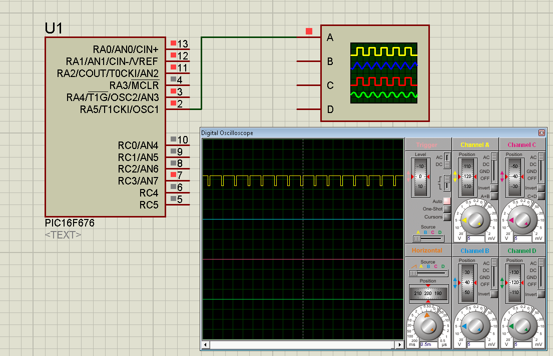

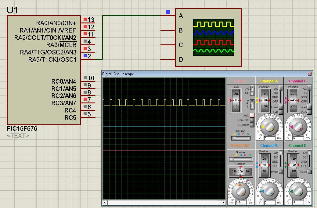

Take a look at these screen shots

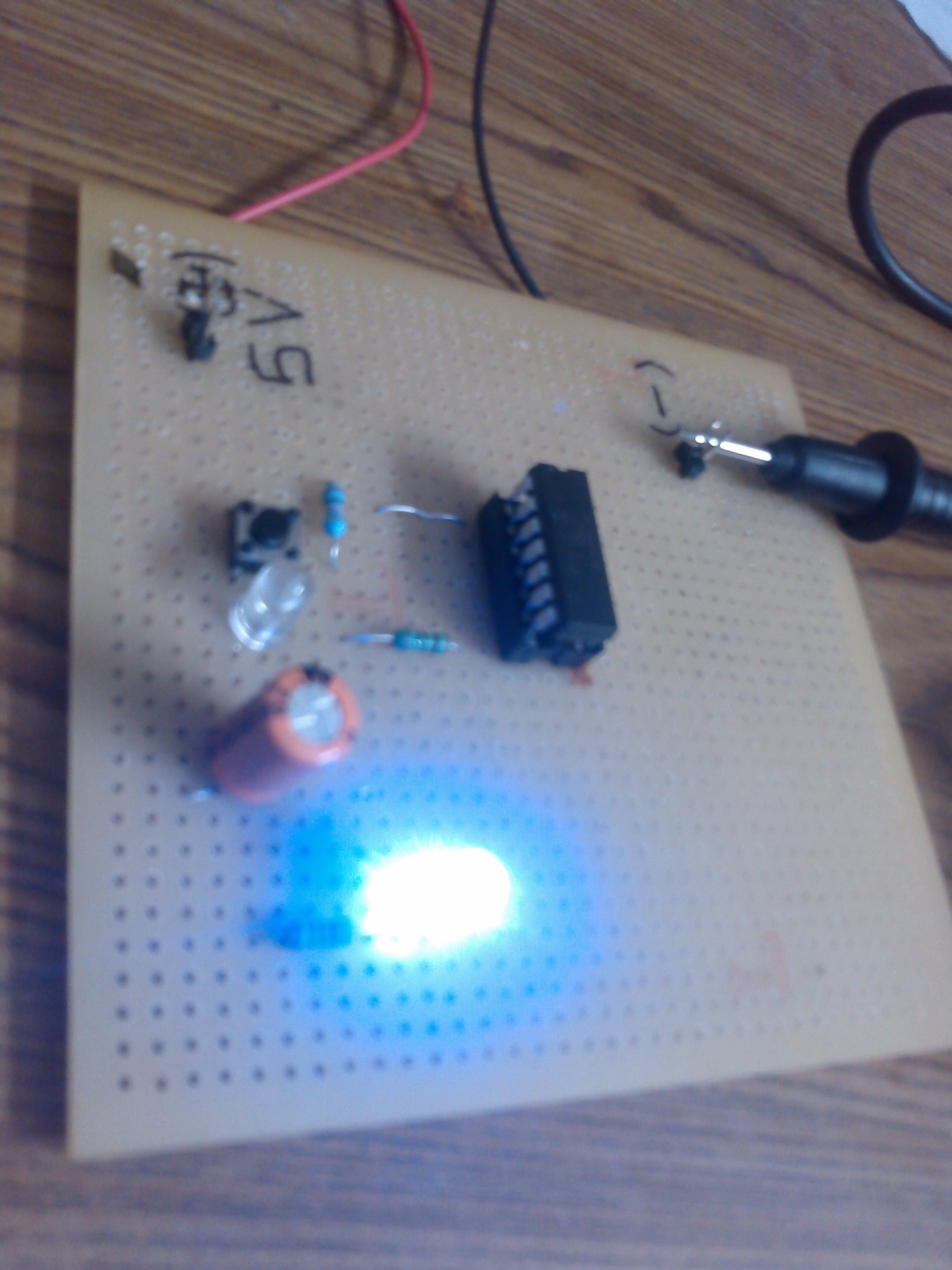

Thanks for sharing the pics, But why is it like i am not getting this output when tried on real hardware.
I am using basic hardware as of now is just a basic thing like the one you simulated
But i am not getting the required output. Please help

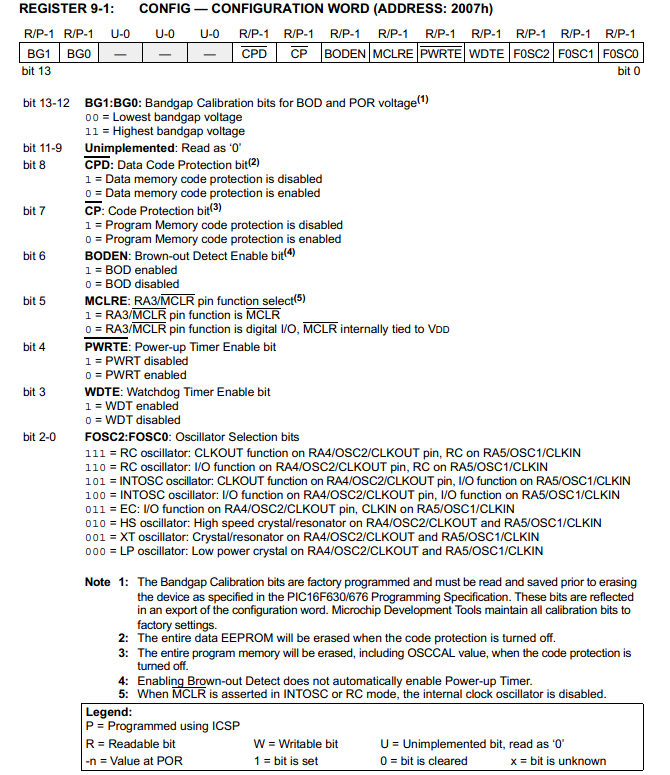

You'll notice that the config bits are always set correctly as I use a HEX value..
Hi Ian,
Without MPLAB IDE nd xc8 compiler, how to generate hex code for this..
__CONFIG(0x31C4); //I am getting symbol not found if i use this in MPLAB
What to do

3) Which compiler do u use ? and regarding __CONFIG macro, the compiler asks me to use __PROG_CONFIG. So if i use __PROG_CONFIG(1, 0x31C4) like this is it fine?

I just initialized RA4 as input and it is showing me 5V if i connect to normal hardware debug board which i used yesterday(uploaded picture in this thread yesterday). please tell me how to come back from this situation

I have removed the config settings which u pointed out and replaced them with __PROG_CONFIG(1, 0x31C4); and eventhough now if solar is present the system is not crashing and PWM duty cycle change is working fine with MPLAB IDE and Xc8 Compiler. Thanks once again for the help
__PROG_CONFIG(1, 0x31C4); // Can u tell me what is the meaning on 1 here, Is it an Instance?

Thanks and i know about that, I was just asking you the need of 1st parameter in __PROG_CONFIG( ),
As you see i have set the 1st parameter to '1', So is it an instance?
Regards,
Suresh
ok, so '1' as first argument is fine? if i dont give anything its returning an error, also i cannot use __CONFIG as it is not supported now by XC8 compiler
