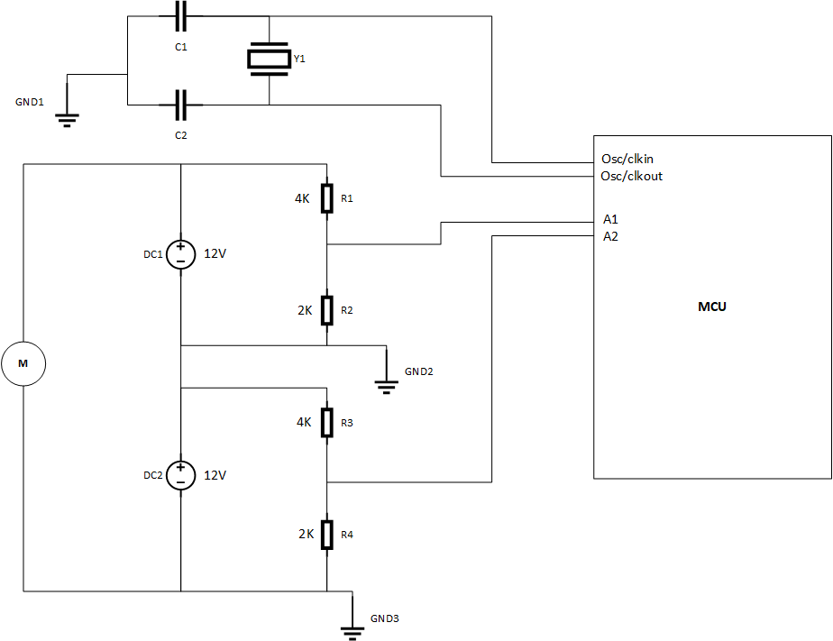

Hi all,
I need some help with a certain digital voltmeter circuit design. I should start by saying that I’m new to electronics so any detailed explanation would be highly appreciated.
I’m trying to make a circuit to measure voltage from 2 DC sources in series, using 1 microcontroller. Here is a sketch of the circuit that I'm trying to complete.
I have some concerns:
  1. Where do I connect the grounds? Grounds for both DC sourcs are different so I can’t connect them both to the same ground as the microcontroller. And by the way, does the MCU have a ground pin? If yes what do I connect to it GRN1, GRN2, GRN3, or all?
  2. I have a doubt about the protection of a 5V microcontroller with the voltage dividers. Are they well sized for both batteries? Specially for DC2, because the voltage in the circuit increases from DC1 to DC2.
  3. Is it possible to take measurements with only one oscillator or do I need a second one?
  4. Is a pic microconntroller suitable for this application? Other propositions?
  5. Any other recommendations?
Thank you in advance for your help..

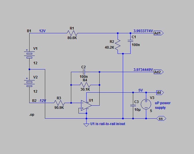

You've connected grounds directly across the bottom battery, and have now destroyed it - and possibly burn your home to the ground.
You can't measure two different voltages like that, the easiest way (with your existing circuit) is to remove GND2 and it's battery connection and connect the bottom of R2 to GND3 - you may also need to increase the value of R1 as well, to give an increased voltage range (10K should be fine).
A2 will then read the voltage across DC2, and A1 will read the voltage across battery DC2+DC1, so to get the DC1 voltage, subtract the DC2 voltage from the A1 reading.
The MCU will have at least one GND pin, and they should all be connected to GND3, only the one oscillator is needed, and indeed only one is possible - a PIC would be fine for the project.

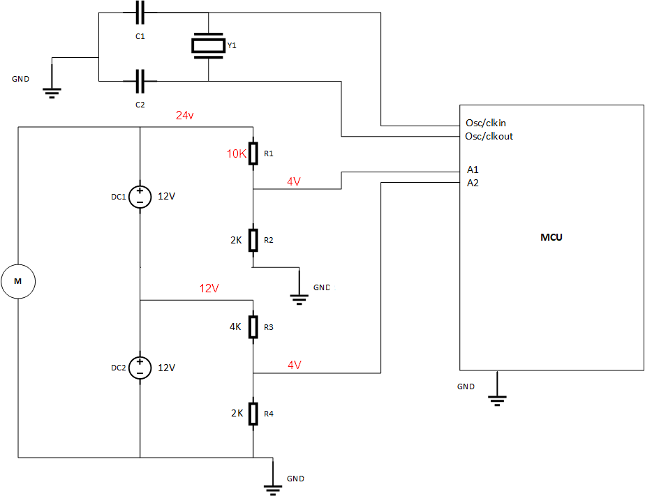

This picture: all grounds are the same.
One node is names 12V and another is named 24V.
To measure the bottom battery you simple read A2, knowing 4V is really 12V.
To measure the top battery you first read A1, knowing 4V is really 24V. This tells you the voltage of DC1+DC2. Now substrate out DC2.

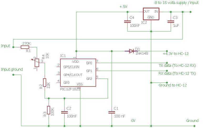

This is the schematic of the voltage sensor.
I now use a PIC12F1840. (I used a PIC12F1822 in the first one I built) The potentiometer is to fine tune the calibration
I also have sensors that also monitor current as well as voltage (Using an INA219) and some that measure temperature and humidity. (Using a DHT22) At the moment I just use a terminal emulator program running on a PC with an HC-12 connected to a serial port. I just type #and a letter and the sensor sends the data as a readable ASCII string of characters. I have been trying to get a Raspberry Pi to read data every few minutes and log it but I am having difficulty at getting the receive code to deal with errors in the transmission. Let me know if you would like a copy of the code that runs on the PIC12F1840
