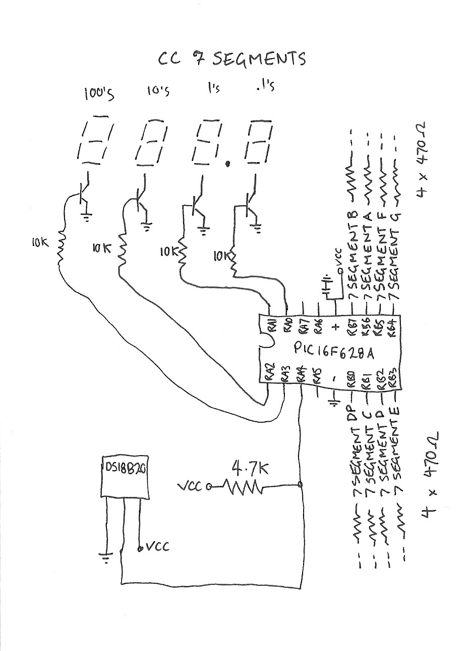

Hey guys,
So I slowly worked through my old (working) OW routines and converted them to resemble the nicely layed out and compress version, in doing so I found an, if not THE, issue that has caused me so much grief.
BUT, I don't know how to fix it.
I will do my best to explain.
In reference to the assembly source file (the link is below in my signature because I'm sick of finding then adding the link to nearly every post)....
My problem lies with enabling and disabling interrupts in the OW routines.
On lines 189 and 215 of my code (in the GET_TEMP routine) you'll see i have 2 instructions, 'disable interrupts' and 'enable interrupts'.
Also on line 275 in the DELAY routine i have an 'enable interrupts' routine commented out.
The interrupt only has a small window of code in which it can be triggered due to the disabling of interrupts for the whole OW routine, therefore the display is flicking randomly and each digit has a different brightness to the other.
This code is working though. I am getting the temperature from the sensor which means the timing is right, and the temp is being displayed which means the display driver is alright.
What I want to now do is get rid of lines 189 and 215, and un-comment the 'enable interrupts' instruction on line 275 as part of the DELAY routine so that the interrupts are disabled for a minimum amount of time, i.e. only during OW communication.
But when I do this, weird things happen.
sometimes a random digit, sometimes nothing...
I'm getting closer and have narrowed it down to this,
Pommie, if you still have that 88 on a Breadboard I would love for you to test this code an to see whats happening with your own eyes.
as I said the assembly code is in the signature and I have added the schematic for the 628a i am using.
Jake.

Can I make a suggestion. Don't disable the interrupts but make sure the OW routines can't be interrupted by doing,
Add a flag to the ISR,
        SWAPF   W_ISR, W                ; Undo previous SWAPF and restore W register
        BCF     PIR1, TMR2IF            ; Clear TMR2 interrupt flag
        [COLOR="red"]BSF     Flags,0[/COLOR]
        RETFIE                          ; RETurn From IntErrupt
And add a wait subroutine,
WaitISR		bcf	Flags,0
W_ISR_Loop	btfss	Flags,0
		goto	W_ISR_Loop
		return
And call the subroutine before any read/write to the OW device.
You will have to replace the read slots (after convert) with a suitable delay.
Let us know what happens.
Pommie, your idea worked.
It seems to be working flawlessly.
Once again, the updated (and working) assebler file is linked in my signature.
I still would really like to know though why the previous way didn't work.
