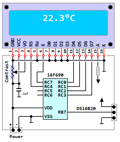

Then you'll have a working display driver template of sorts for an Indoor/Outdoor Thermometer, or a RTC/Calendar/Alarm, or an Appliance/Photo Timer, or a Stop Watch, etc.
Regards, Mike

I would be happy to post the 16F690 program and schematic if you or anyone wants to see it.
More later. Regards, Mike
I would love to mike. It may help me realise what I'm doing wrong in my program.....
Here's the crude 16F690 + DS18B20 + LCD program and schematic. It could be ported to a 16F628A pretty easily.
Regards, Mike

Thanks Mike.
picked this up on line 241...
bcf     OPTION_REG,NOT_R[COLOR="darkorange"]A[/COLOR]BPU
is it supose to be NOT_RBPU ?

Hi Jake,
I suspect that bit label is called "NOT_RABPU" on the 16F690 instead of "NOT_RBPU" as it is on the 16F628A because the 16F690 has weak pull-ups on PORTA and PORTB while the 16F628A only has weak pull-ups on PORTB.
I don't think that delay is necessary. I copied it from an old program. The Datasheet doesn't say anything about a required delay between sending the "convert" command and reading slots. Sorry!
I'll take another look at your code but I'm not very good at analyzing other peoples code. Sorry!
More later... Regards, Mike
