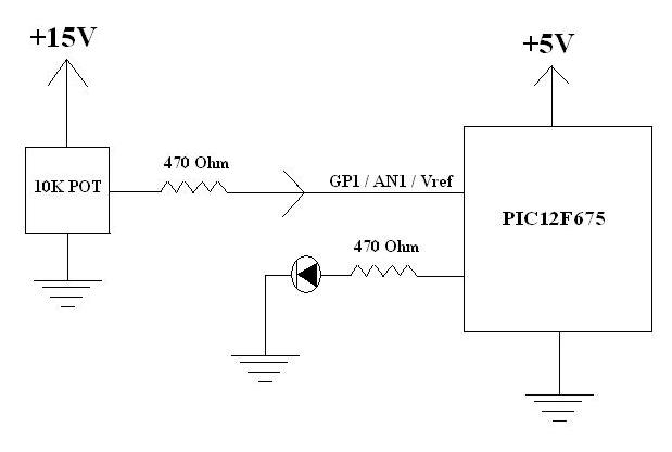

I wish to do a simple ADC experiment. Please see the enclosed diagram.
Before the PIC is placed in the circuit, the 10K pot is first trimmed to get steady 5.03V MAX output from the 15V DC supply which is a steady variable DC power supply. The 5V supply for the PIC is provided from 78L05 regulator IC. The ground reference is the same for the entire circuit.
Now when the 15V DC supply is at 15V MAX, the 10K pot output reads on volt meter as 5.03V. Similarly if the 15V DC supply is lowered to 10V, then the 10k pot output reads on the volt meter as 3.4V. I assume that these voltages are also seen by the PIC ADC pin (AN1) as shown in the diagram.
My program below simply checks to see that if the ADC voltage is equal or above 3.4V, then the PIC turns on the LED. If the voltage drops below 3.4V, then the LED remains off.
Sadly this is not happening and the LED remains on even if the DC supply is lowered down to 6V. Then the corresponding voltage out from the POT reads 2V. I have tried varying the "ADC_Result" variable value to a much higher vaule (800), but even that does not help and the same problem remains.

Your 10K pot is causing the PICs diodes to clamp to VDD. Try a 2.5K pot with a 4.7K resistor between it and the 15V. The 470 resistor probably saved that little I/O pin.

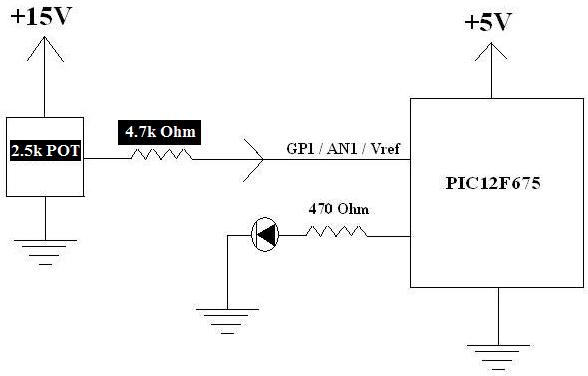

Please can you verify that I have understood you correctly by taking a look at my revised diagram enclosed with this post. I have added the 2.5k POT and the 4.7k resistor just as you have said. Is this how you mean it?
Thank you

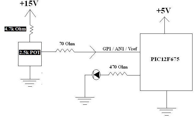

ok so now please check my diagram again...I have redrawn it agian.
is this what you mean?

Your code says;
    ADCON0.ADFM = 1;  //Result Right justified
    ADCON0.VCFG = 1;  // Voltage Reference is Vref
Your ADC is looking for the Vref on the Vref pin, which you have nothing connected to. So it wont work.
Try changing your code to;
    ADCON0.VCFG = 0;  // Voltage Reference is Vdd (+5v)
