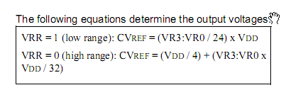

I would add a low value resistor in series with the CIN pin, say 1K.
The PIC's internal diodes will not be turned on with such a low voltage as 0.11Vac, but the 1K will limit the input current should the CIN voltage ever exceed approx 0.5V.
Look at page 35, Section 6 of the 12F629 datasheet for the comparator.
The values at which the Vref can be set are in internally fixed discrete steps, choose the Vref that suits your App.
E.
EDIT:
With a +5V supply the lowest you can get for Vref is Vdd/24= 0.2V
You could use an external OPA to raise the 0.11Vac to a higher voltage.

Hello,
I have decided to work with minimal voltage 3,125 V AC (can I use AC voltage on comparator input?).
With:
VRR=1 and VR3 ... VR0 = 1111 (15) with a VDD of 5V the Vref will be (15/24)*5 = 3,125V.
I have made a code but I am stuck :(
