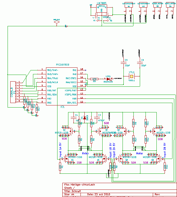

I am about to make a PIC driven H-Bridge circuit board. It needs to be able to switch each of the 4 Mosfets on/off individually.
Previously I made one that switch 2 mosfets each time. Using 'N' IRF7413ZPBF and P IRF7424PBF See attached SCH:
This works well, but now I need 4 switch circuit, if anyone has one please.
Also I have never used PWM for switching mosfets, has anyone got experience with fast switching of mosfets please.
Cheers, Camerart.

Your posted schematic is too low in resolution, and drawn in a convoluted way, to actually provide an opinion.
It appears though, that your upper Mosfets are always biased on.
Setting aside that, to control all Mosfets individually, you require a pair a things:
-a way to level shift the pwm drive signals for the upper Mosfets.
-a way to provide independent bias voltage for the upper Mosfets.
This can be done with discrete components, but to do "fast switching" (fast meaning how many Khz?) tailoring the individual component values is difficult to prevent shoot-thru and other faults that cause immediate and catastrophic destruction.
I can advise you to search on the International Rectifier's webpage and look for H-bridge drivers. Intersil also has a good selection.

Hi Schmitt,
I've re-sent the file as a gif, see if it's clearer. Sorry for the convolution, I draw in a way that helps me visualise circuits, (amateur:))
What happens is when one of the bottom 'N' type mosfets switch on, they pull down the gate of the top 'P' type mosfets to the required level, which switches them on.
The switching could be up to 720Hz. so it looks as if it's slow switching.
I have an idea, I'll draw and post later.
Camerart.

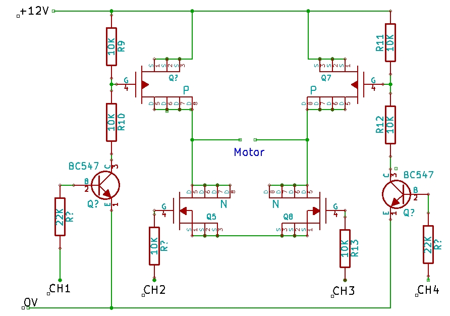

I've moved some of the components from my 2 channel SCH, to make a 4 Channel version.
Does it look ok?
Camerart

Your High side FETS need a bit more voltage than you have got....
I found that you really need to use High side drivers..... The gate voltage needs to be higher than 12v for them to work properly.... Also you could do with a big cap across the power rails...

To fully open a P type MOSFET you need to raise the gate voltage above the source voltage..
What voltage are your motors.... If it is a 6v motor you could feed the source of the top fets 6v and control them with 12v... PWM usually is Max on Max off if you turn on your FET's in your example you wouldn't reach pinch off...
They recommend 10v above the source to fully turn on a P type MOSFET...
High side driver chips use a bootstrap circuit to generate this high voltage... As the current needed is very low simple components are used..

I chose these mosfets because I was advised to get low RDSON ones, does this make any difference to the gate switch on voltage?
How I have understood the design: Is it true that as the 'P' mosfets are negative, and I pull the voltage down to 2v, then in a negative sense, this is 10v above the source voltage. Correct me if I'm wrong! So if that's correct, I need to change the transistor resistor values to bring it down (Up) from 6v to 10v. If this is correct, how does this workregarding the suggested 10 ohm gate resistor?
When I said 720Hz, I was getting mixed up with the quadrature encoder side, I'm sure the PWM will be as you say 20KHz.
The have internal flyback diodes.
Camerart.

Tech support has muddled things. He made the newbie mistake of giving you the threshold voltage which, as the data sheet shows, is the voltage where it just starts to turn on at a drain current of 250μA.
If you look at the Rds(on) value you will see that it requires Vgs = -10V for an On-resistance of 13mΩ and Vgs = -4.5V for an On-resistance of 22mΩ. Thus you want at least -4.5V for Vgs to fully turn on the MOSFET and -10V if you want the minimum ON resistance.

Thanks for spotting this. I'm a bit lost with the On-resistance information. As you can see I used the same 'P' channels switch on resistors as in SCH #1, this brings the gate voltage down (negative up) to 6V. Should I change them to give a -10V (2V negative) gate voltage. ( I use the negative reminder, as it is a bit complicated using negatives for newbies, and me)
Would you be good enough to also check the 'N' mosfet data sheet for me please, or does the TTL value switch these ok? I assume it is ok, because I've been using SCH #1 circuit for years. 'N' IRF7413ZPBF and P IRF7424PBF
The On-resistance information tells you what gate-source voltage the manufacture uses to characterize the on-resistance. That means you should not normally use less than that if you want the MOSFET to operate as a switch with a low on-resistance.
Both the transistors you listed are characterized at both a Vgs of 4.5V and 10V so you can use either value, depending upon how low you want the on-resistance to be. Thus 6V for your circuit should be fine unless you want the absolute lowest on-resistance.
If you operate the N-MOSFET from a TTL output, which is typically only about 3V, you should add a pull-up resistor (say 1k) from the TTL output to the +5V voltage so that the gate voltage goes to 5V when the transistor is on.
