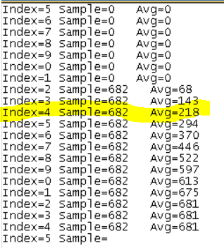

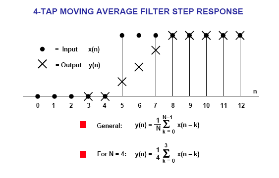

I hope this doesn't pull the thread OT, but I do not quite see what you are doing in Post #486:
The first value (68) is easy to get. With some crazy assumptions, I get the next value. But I cannot get the third value. Does it ever settle to 682?

But there seems more to it than that. My main reference for the math is this: https://www.analog.com/media/en/training-seminars/design-handbooks/MixedSignal_Sect6.pdf Specifically, I am referencing Figure 6.8 in that link:
Can you explain, perhaps by a worked example, how you get the highlighted value? Also, why it doesn't seem to settle on 682?
Regards, John

Hi J2,
I'm guessing that when E, simulated these numbers, he set the INPUT and watched the result. On the PCB the INPUT is changing all of the time, so I assume that eventually, the result would show 682 using the SIM, but not on the PCB.
The D/S strongly suggests that 'Burst READ' is used. This is to avoid READs of different columns happening as one of them rolls over, so between 09 and 10 could READ 19. or 190 with a different column.
Is this a possible reason that the READings jump about a bit?
C.
Using Singles in the program as a replacement for Words is not a problem.
The posted Basic program was to show only the principle of averaging a ring buffer.
The final value does converge, this modified program shows that, also has only 5 index's. Uses 12345.56 as the sample value.
