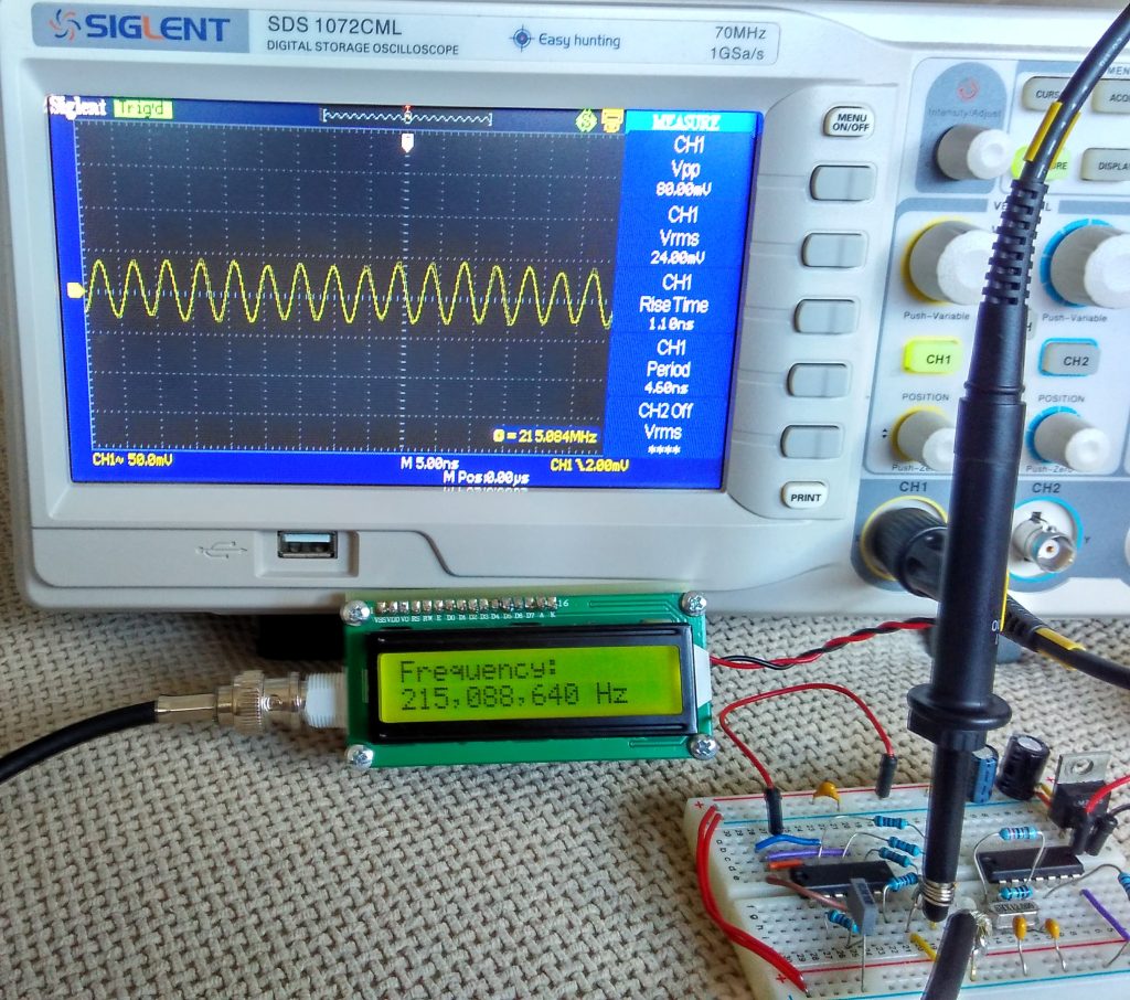

BTW, I came across an interesting "dual 16-bit counter" IC awhile back that might make a nice 100-MHz Frequency Counter.
