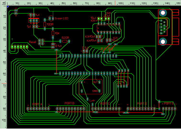

Just one note. Your tracks are a bit close togather. Try spacing them out, especially since you seem to have board space for it. Also, try using thicker tracks.

Hiya Guy's,
Well after playing around with a breadboard today and I ended up nearly taking a 4 pound hammer (as the breadboards here in Oz are crappy made in china junk) to it I've decided to bite the bullet and finish of my development board I was working on a few months ago. Below is the modified design and I've decided to go with a few link rather than put tracks between the pins of the IC's( these are shown in red). I've also put in a 6 pin ICD2 header for programming and debugging and I know the 18f series have different pinouts for the ICD but I'll be concentrating on the 16fxxx chips which are all pin compatable.
Just one queston on the serial connection I saw on the net when I first made the design of linking the pins not used, would it matter if I just say had the earth and the rx and tx connected and got ride of the other tracks?.
Cheers Bryan :D
It depends on the software you use on the PC side?, as long as hardware handshaking is disabled then it will work fine - but adding the simple links makes the hardware handshake connections for you.
